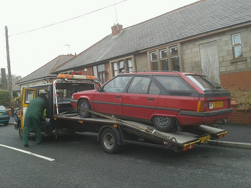

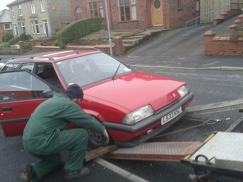

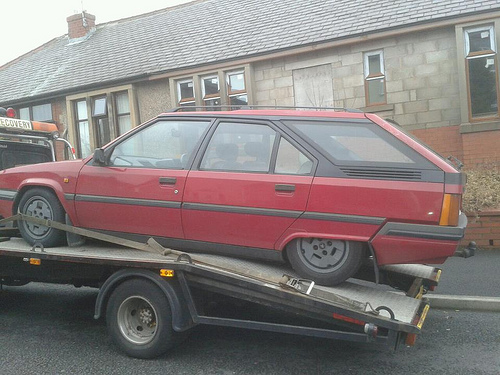

BX was collected today. No drama.
63654_10152163881658475_680768229_n by Wooscary, on Flickr
781_10152163882353475_1988315125_n by Wooscary, on Flickr
72800_10152163882973475_804256041_n by Wooscary, on Flickr
That's Chris loading it up, throughly decent chap. He custom built that tow truck to be just right for hydro Citroens! Apparently he'd already picked up a 16v this morning which had had a mishap in the middle of a busy road. Whoops. Anyone on here?
Photos of Breadvan will appear on my blog thread.
