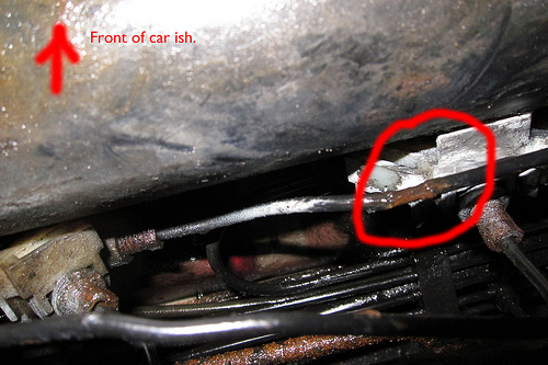

Right I think the leak has been discovered.
IMG_3885b by Wooscary, on Flickr
This looks to be the culprit. Corroded, and when the area was dried off it was still seeping.
It's the pipe that goes from the centre of the car, heads towards the outside of the car, goes in to a
nice spiral and disappears to somewhere off near the wheel/suspension unit on the offside rear of the car
(why has everything been going wrong with the off side rear eh?).
Looks like a bit of a bastard to route. So It's looking like I'm going to have to have it recovered which is a pain.
My plan is to find someone to pick it up and take it to the Citroen Repair Centre in Stockport, who have always done
good work for me. I've never had a car recovered before and can see the pound signs whizzing. Does anyone have
any tips please?
Cheers.
any tips please?
Cheers.

From the picture it looks like a suspension pipe (memory a little fuzzy) but if it goes to a coil then it will be the pipe to the rear brakes. If the latter you'll only lose significant fluid when braking, so will be fine to raise the car for recovery. Can you try starting the engine and raising it?
The only spare pipe I have in stock in that area is one of the pipes to the rear cylinders, which if it helps I could let you have so long as you replace it when you can get hold of one.

Would there have been sufficient pressure to lose a lot of LHM if it were a brake pipe and the brakes were not being used?
It definitely looks like it goes to the coil.
It's up on stands at the moment, so I suppose even if I start it up and see if it will rise I won't be in a worse position as it can't sink any
further?
Thanks for the offer Mat, I'll probably have to figure out a definite way to identify the pipe first or it might be a wasted
parcel!
further?
parcel!

Sounds like a suspension supply pipe that's gone. If it's one to a rear ram, then you may be able to crimp it at the break to block the flow enough to get some sort of lift for loading onto a trailer, although a lot of experianced recovery companies know the tricks needed for loading up a dead Citroen.
