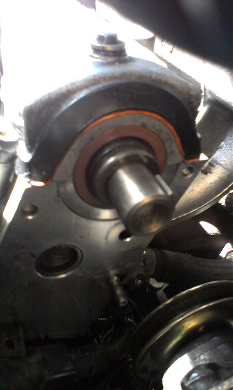

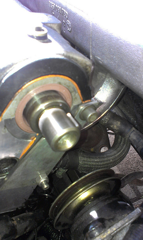

Decided that a direct air con swap is not the way forward (I.e. I shall remove it from the scrapper and fit it at a later date into my replacement) so I refitted the heater box. Once fitted, I noticed I hadn't put the the heater matrix back in. So, unbolt the steering column and loosen the bolts to drop the heater box. Ok, done.
Fill her up with water and crank the engine over at 5 second intervals. Before she fires up, I thought I'd check for leaks. Fakin' oil everywhere.
Oooops there's a hole in my head. Well, the cylinder head. It's the hole slightly 'eclipsed' by the camshaft.
On the previous head this hole was blocked by an M8 grub screw. But in my new head, there is no thread to take this grub screw. The hole will need to be drilled and tapped but I ain't doing that with it on the block as swarf will undoubtedly drop into the oil ways. As a temporary measure, I made up a plate and a rubber gasket to seal the hole. The mk 1 version didn't work so I had to alter it slightly.
The temporary fix:
Eventually, the fix worked and eventually she fired up. I left her running for about 20 mins, checking the header tank, opening and closing the bleed screw, checking for leaks etc. after the 20 mins I felt the radiator - stone cold. Suspect the thermostat as head side of the housing was pretty darned hot, but only tepid on the other side of the thermostat.
I gingerly tweak each bolt in turn and sure enough, two of them are seized. So I now have to replace the thermostat housing but with the later labyrinth type. GRRRRrrrrrrrr.
Still, whilst she was running she ran quite sweetly. I also knocked over my box of bolts sorted into m6 and m8. Happy bunny not I. Take a deep breath, drink 50 pints of cider and two gallons of winoplonk and start again next week once I'm out of hospital!

Re: Pigeon Restoration
BX Bandit wrote:Oooops there's a hole in my head. Well, the cylinder head. It's the hole slightly 'eclipsed' by the camshaft.
I take it the head came from a car with a vacuum pump on that end of the camshaft? Apparently some heads had this hole blocked off with a ball bearing and the aluminium then peened over.
Post by BX Bandit »
YEs mate, came off a pug 306. But was the oil way left open to lube the vac pump? In any case it's irrelevant, darn pain in the doo dah.
Fuckin hate cars me!
1990 BX 16V Platinum Grey
1990 BX TGD White
That's right. Jaba came up with the good idea of screwing in an oil pressure sender there to blank off the hole, but your point about swarf still applies.
Post by BX Bandit »
:) it is a good idea although I 'think' it'll foul the cam pulley, not sure though.
My dad has some proper gasket material and I'll make another plate out of 5mm and use the 3rd tapped hole to the left of my leaky hole in addition to the other two.
Post by JayW »
Wouldn't a small piece of 8mm o/d rubber hose smeared with silicone slip into the hole and then screw a short bolt or screw into it? (along the lines of a rawlplug and screw expandy-type idea)
I've got some pretty standard 4mm silicone hose with 8mm o/d in the garage so it's fairly available.
Just an idea!
Post by DavidRutherford »
Yes.
The hole is slightly under 8mm. An 8mm ball bearing, a punch and a fecking big hammer will fix the "leak".
Alternatively, a short length of brass bar beaten in will do.
Or tap the threads then spin the engine over to spit oil and swarf out?
Or tap the thread and then use a piece of small bore pipe (like a drinking straw) in a vacuum cleaner hose to vacuum out all the swarf?
many options!
