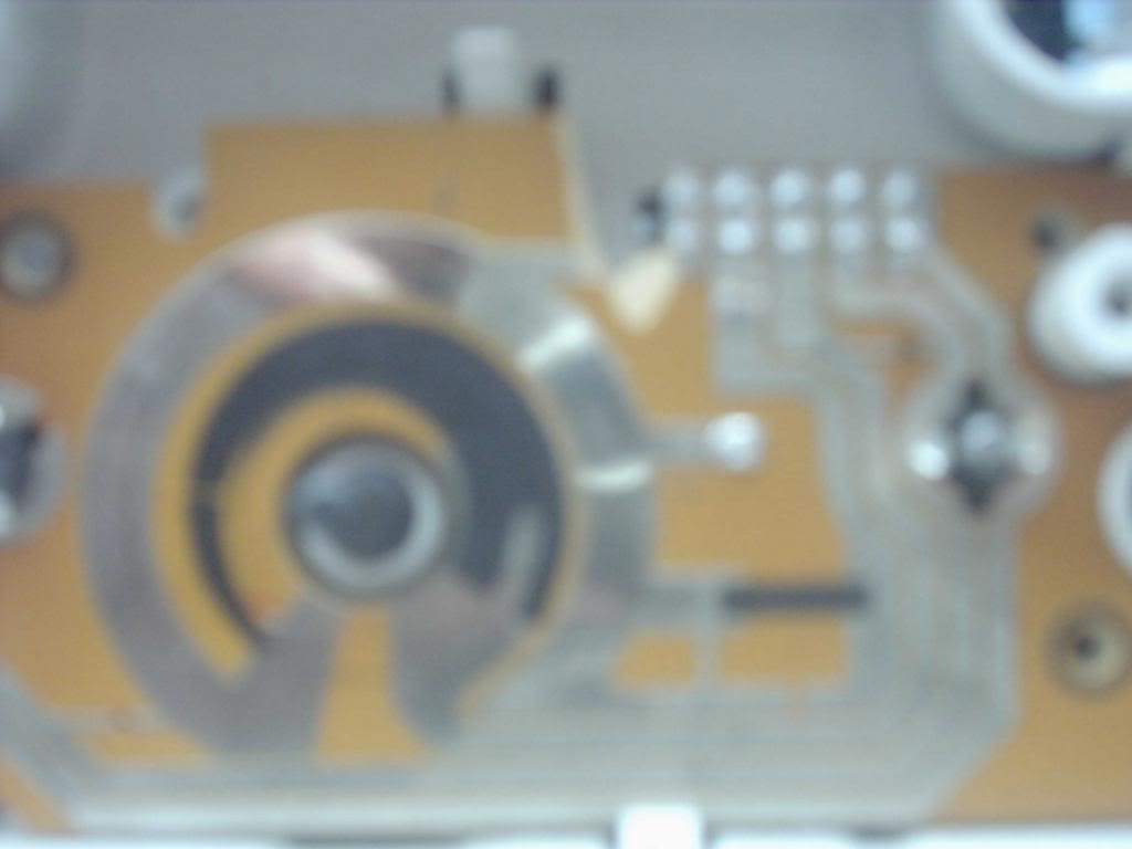

Vincent, just in case you don't know you need to drain the coolant out with the cabin heater control dial on hot as far as you can.
The micro switch on heater control dial is mounted on the back of the white assembly you mention. Neither that micro switch or the air recirculation micro switch will not cause the air con to mal function.
However, the sliding control (a potentiometer) can either home worn or get dirty, meaning the circuit is made. It is also held on by two aluminium tabs that are twisted to keep it 'mounted' to the white panel. If its been removed a few times these little tabs fatigue and fall off.
As you slide the potentiometer, you should hear the air con control relay click in. The control relay is mounted somewhere in the cabin, close to the three heater/ventilation/fan speed dials.
Along with the control relay click, you should hear the engine radiator cooling fans come on

Secondly, this removal of it,s coolant will be time no.5 for the same fliud :lol: Because the heater tap won,t go onto hot, this makes me have to remove quite a few hoses, to make sure that the system is bled properly.
With regard to the micro switches, I could only find one and that one was for the recirc switch. And after reading your most informative reply quite a good few times and also looking at Vanny,s very kind pics, the penny finally dropped :D
Today I carefully gingered out the white heater control panel and all of a sudden the air-con relay and the two air-con fans started working =D> :D So I removed the two wires connected to it and carb cleaned them and spray greased them, tightened them and refitted them both and they were still working, so I have refitted the white part of the heater control panel and given it good ole thumping on the top of the cover of the for the potentiometer and up to now it hasn,t packed up :lol: So thank-you so very much indeed for that one =D> :D 8) ( I wouldn,t have had a clue on that one ) :roll: and at least now if packs up again, I will now where to look next time. I did try starting the engine to see if the air-con was working, but unfortunately it still isn,t working, but atleast we are one big step closer to getting it working =D> :D
Many thanks indeed, I could,t have done that without your very very kind advice, thank you so much indeed =D> :D

Re: Trying to get the air-con working.
BX Bandit wrote:However, the sliding control (a potentiometer) can either home worn or get dirty
Very good point, I've had to replace mine once already. For future reference for anybody reading this thread, it's a 10k ohm linear potentiometer, with a Valeo part number of N22-109968C (it's on my desk as I type :lol: ) I couldn't find a linear pot of the right dimensions, and made do with a rotary pot until I could find a second hand one.

Secondly, I havn,t drained the old air-con fluid yet Vanny :wink: There was what seems to have been a bad connection where the 2 small wires that fit onto the potensiometer for the air-con switch, I have cleaned, lub,d and removed and tightened them aswell. As I was working on her today I touched something around there and all of a sudden the air-con relay started working and the two fans in front of the car also started workling =D> :D :D After reassembly and some vigarous thumping it still seems to be working really well. I did start the engine on her with the newly working air-con relay and her fans, but unfortunately it still isn,t working. But we are one massive step closer today thank-you very much =D> =D> :D Brill.

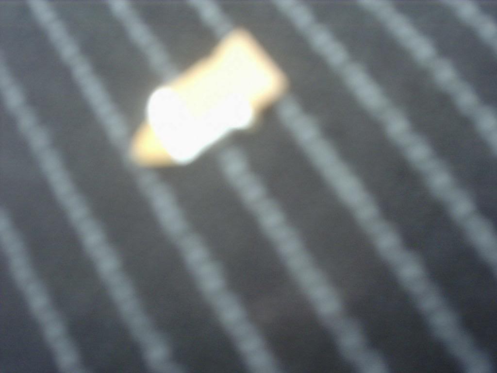

Dear All,
Hopefully Shari has downloaded some pics, that may help, they are a little blurry because I forgot to press the button to focus them.
Fingers crossed
Vince,
