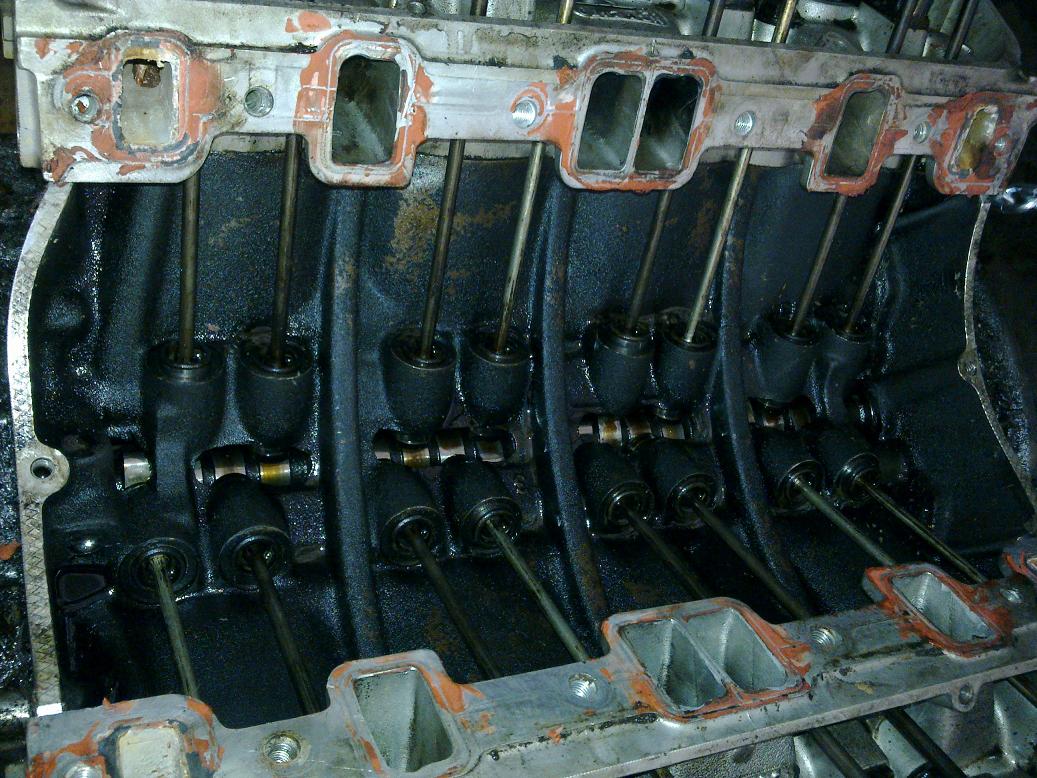

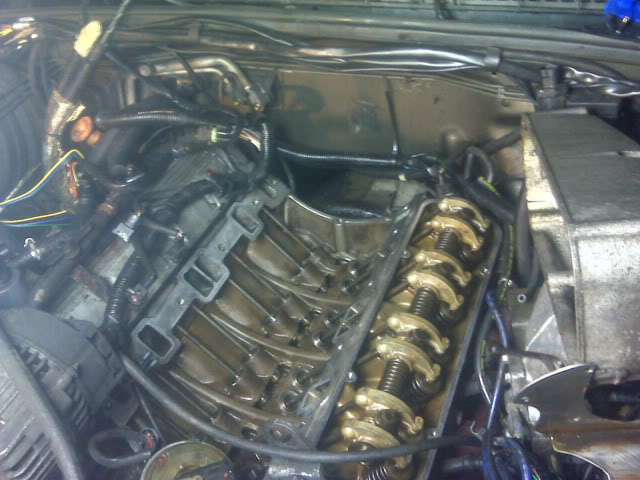

As an aside on LPG (which I am a fan of if you hadn't guessed), this is the inside of a Rover V8 engine after 142k miles (the last 130k on LPG):
Compare that with a picture I found which is similar to how another of my engines looked inside after 136k miles:
Obviously, cleanliness is only part of the picture and oil will still suffer from thermal breakdown at the same sort of rate, so I wouldn't advise extending oil change intervals when running on gas as some people do. But I do wonder why more effort isn't put into LPG vehicles supplied from the manufacturer in this country. Italy especially seems to be way ahead of us in this respect. If you look at the differece in emissions (the ability to pass a catalytic converter emissions test on gas without one fitted for example) it seems like a no-brainer.
