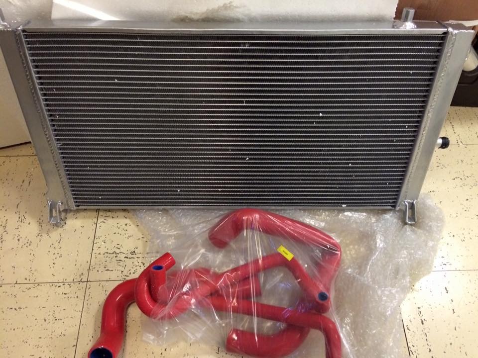

Ive posted this on the FB page but for people who aren't on there here is the post I made earlier
Present came in the post from China today - one re-manufactured TZD Turbo spec Aluminium rad and a set of red silicone water pipes :D not sure when it'll be fitted yet but I'm looking at upgrading the cooling fans at the same time - so a special THANK YOU to KevR for going though the trouble of getting these re-made
One happy chap and soon to be car here :D
