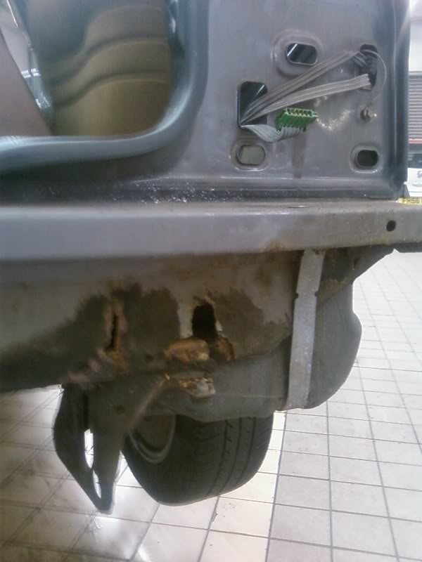

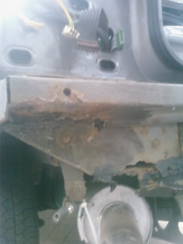

This is what we found when the rear of the car was stripped out.
Rear Panel
Drivers side rear innerwheelarch!
Plus the boot floors rotten on both corners!
16v is going to be stored for a while until I can afford to get that lot fixed, oh and there more at the front end too!

Looks that way dont it, we think its down to the fact that I had a 6 disc changer fitted by halfords with a head unit (special offer thing) in 1999, teh drilled four holes to bolt it on, which then rusted, let water in which collected in the corner of the boot floor and rusted it out.

None of that is beyond repair, it's all the usual BX rot spots really. Decent afternoon with a MiG, sorted. It's all easy construction, nice flat bits of tin.
You want to start dipping your polishing cloth in waxoyl Tim!
