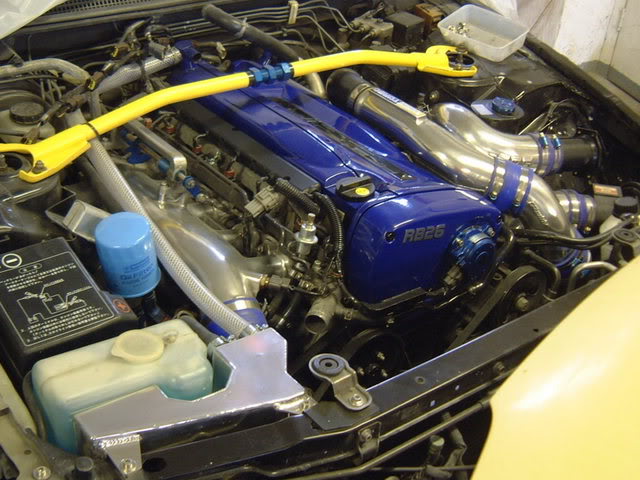

kermit the frog
Posts: 673
Post by kermit the frog »
Hi Doc
it's only me again here is the engine bay i am sure you will appreciate it it's a Image
bit tight the engine gearbox and front x member have to be lowered out of the car and its kin heavy.
this picture was taken prior to the fitting of the new rad and intercooler.
Regards kermit :)
Ooooh, shiny!
I like shiny!
Top stuff mate.
