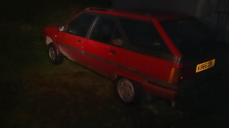

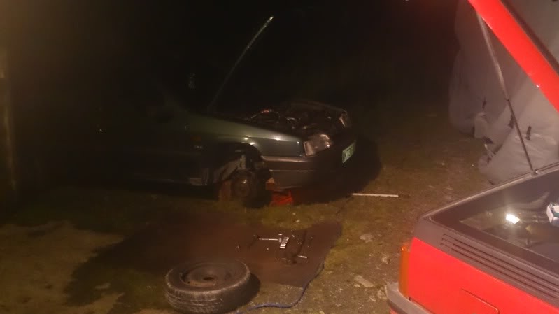

Then late on Saturday I took two of the BX wheels to a local 'one man band' tyre fitter, only to get a subsequent invitation to do some off roading the following day. This was a problem, as the BX was on two wheels, and blocking in all other transport.
So I put the spare on, and moved it!

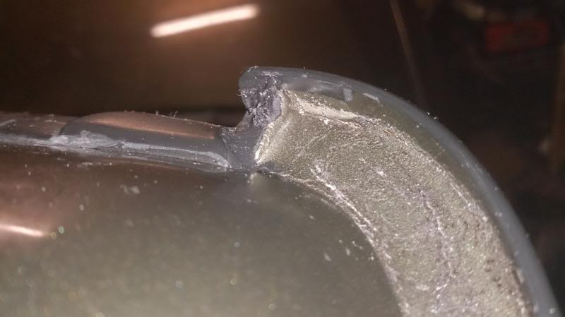

Unfortunately the ground was a bit uneven so I scraped the disc shield slightly. But managed to move it, and take off the remaining two wheels to drop off on my way on Sunday. Got back this evening, re-fitted the wheels (in the rain :( ) so am looking forwards to see how it drives tomorrow!
