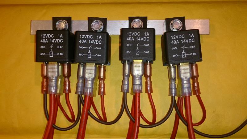

Back to the BX now - I thought I might have cured the ABS light coming on, but no
Seems like a different problem though, as I no longer seem to get it flashing on over the odd bump or tight corner. Now it stays on dimly most days, although will sometimes go off when the glow plugs turn off (I have the 'afterglow' plugs and relay from a Xantia) or if the engine is restarted on the move. This leads me to think it's a voltage issue, but the battery voltage is OK; not yet measured the voltage at the ABS ECU.
I've been meaning to bypass the ignition switch with a set of relays anyway, as the starter motor contact has a voltage drop across it so suspect the others aren't too good either. Must pull my finger out!

Re: Mat's BX Blog
Yeah, I figure one problem has started as another was cured! That said, it went out as normal this morning...
Wired up a set of relays to take the load off the ignition switch - arguably it's curing the symptoms rather than the problem. But on the other hand by reducing the current through the switch, you're minimising any voltage drop and any that does occur would be unlikely to stop the relay coil from operating. Plus it means that the bits likely to fail are in standard, easily replaceable relays rather than the ignition switch itself.
