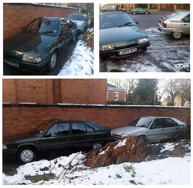

It's silver . . .
. . . and very nice too! It does need quite a few things doing to it get it really tidy (infact the list gets a bit longer every time I drive it) but nothing that can't be done while it's rolling. One of the advantages of this slippery snowy weather is that you can't even tell it hasn't got power steering - whoah - easy tiger!

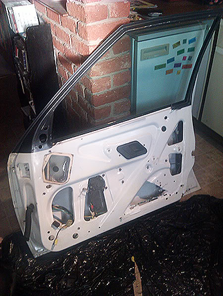

The Hurricane is currently languishing under a cover on my friends car port. A couple of weeks ago it got broken into, and although nothing was stolen or damaged the window surround on the drivers door was bent beyond repair. I've had to source a new door which I'm currently prepping before it goes to the body shop to be painted and hung next week. Once the work is done it will probably look tidier than before the 'incident', but it's been a load of hassle, expenditure and grief I really didn't need - oh well - c'est la vie!

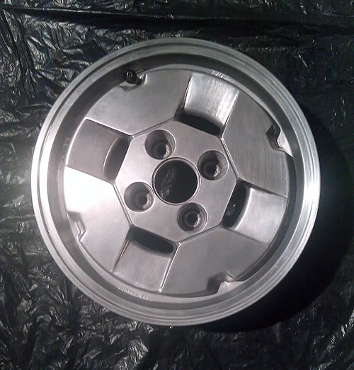

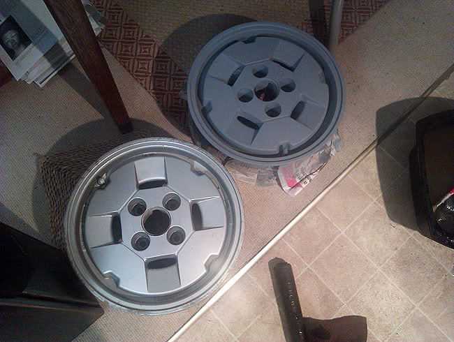

I've also been busy refurbing the alloys (I decided I couldn't live with the crumbly bits in the middle of one of them). Anyway, one way or another, I'm hoping that Vert Triton lovelines will be resumed asap!

Yes, I remember now Paul, the Bradford registered one :) She
does look very, very nice doesn,t she Paul :wink:
I like the one about the list getting longer evrytime you drove it,
I had that problem, and I wasn,t driving at all. :lol:
Is that black part on the bottom of the front bumper, the spliiter
that you have been talking about then Paul :?: nice new rear mudflaps
too Paul 8)
The paintwork looks very very nice doesn,t it, especially the match
on the cars paintwork and the colour coded bumpers is very very good
isn,t it, and so shiny the best silver one I have seen for ages Paul.
So sorry to hear about the door Paul :( Why can,t people just
leave alone what is not theirs, they wouldn,t like it someone did to their
car would they :x you have been very lucky to get a new door for her
Paul, But as you say though alot of work too.
Nice paint job on the alloys Paul 8) It is so difficult to get that kind
of quality of finish that you have there Paul, especially the laquer has
to be just right doesn,t it :!:

I'm refurbing the alloys one at a time as they are - to say the least - 'labour intensive' if you want something that looks like a factory finish - which I do! One of them in the pic I havn't started at all and the other one is only primed - with etch primer for alloys. I couldn't find a code for the silver so I got a motor factors in Bolsover to match it. I should really have used a two pack lacquer but I don't really have the facilities to use it safely and once it's mixed you have to use it the same day or it goes off - which is a bit inconvenient if you're pushed for time and space. Instead, I used Halfords PU lacquer which is a super hard acrylic designed for alloys, but I think Upol make a good one too.
To get a good finish, to avoid spitting and aid the paint flow I warm up the paint and the surface to be painted then apply the paint in lots of thin coats, carefully drying it off with a hairdryer between coats. If you really scrutinise the finished article it's not quite as good as a gun and compressor as an aerosol can't atomise the paint quite as well - but it's as near as dammit!

Looking forward to seeing how good your alloy's come up, i've got a few sets that could do with the Paul touch :wink: :lol:
MULLEY wrote:Looking forward to seeing how good your alloy's come up, i've got a few sets that could do with the Paul touch :wink: :lol:
Depending on how bad the wheels are, sometimes its worth getting them shot blasted beforehand, we have a local company that charge about £10 a wheel to get them down to the bare alloy, which is what I normally do.
Bare alloy . . .
. . . just Nitromors and elbow grease - and shot blasting won't file out the kerby dinks either! Having said that I used so much elbow grease I might give the shot blasting a whirl next time - I'm knackered!! :shock:
