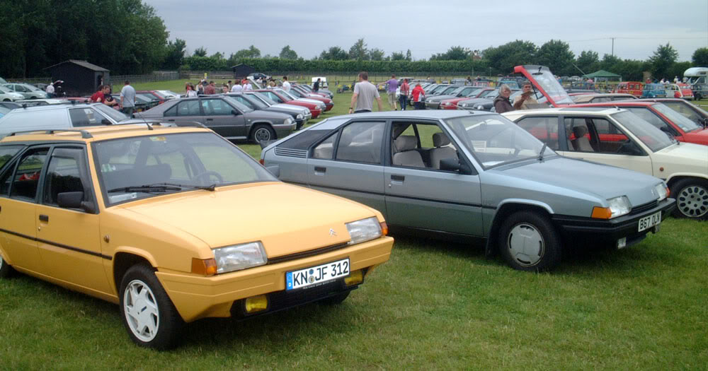

And I wondered what a BX would look like if the window surrounds were the same colour as the rest of the car - the orange looks good that way.I do like bold, flat colours.

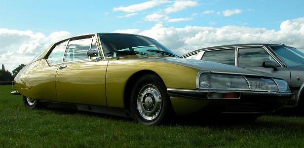

Remy has a Citroen colour chart for the Mk.1 BXs and there was featured such a green - a bright apple green - never seen a BX in that colour though.Any ideas what colour yet? I've never seen one in bright green, but there may be a good reason for that...
electrokid
- Posts: 1764
- Location: Woking
Lovely colour, on a sleek SM, the estate being a bit more slab sided though, 4x4s are rare anyway, see what its like when all polished up, and yes I will give you a hand if neededelectrokid wrote:Not 100% sure yet - but I liked this slightly greenish gold seen at Stratty.
