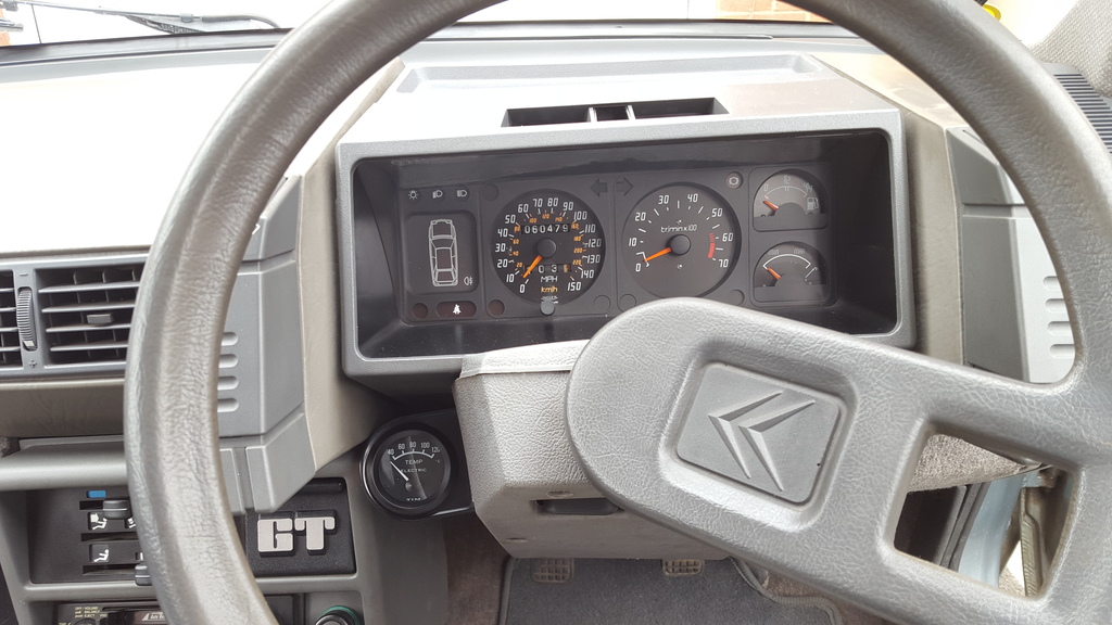

Having a working speedo is amazing, this one's never worked! I think it's ended up with a MK1 lower (longer compared to the MK2 lower) and a MK2 upper (longer than a MK1 upper!) so there is some curvature to it, and initially the speedo wobble below 40 was quite comical! But driving it last night/this morning that had virtually disappeared, so im hoping with use it'll go altogether.

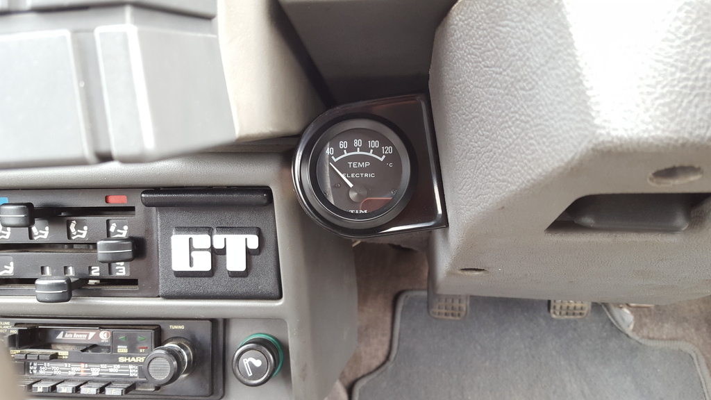

It's also great to know the engine temperature, I chose the 'TIM' guage because it looked unobtrusive and wasn't as expensive as some of the really nice ones. However, the needle travel is less than 90 degrees, so less than a right angle from cold to nuclear (120deg) which when the engine is on the hot side means that there is very little travel from fans kicking in to potentially overheating, even stuck in traffic yesterday (was quite warm down here) it never went above what I guess is 98 or so degrees, just below the 100 degree line. I know the yellow light of doom doesn't work but the red does - only just discovered the MK1 dash light check button!). Running temp seems to sit at about 85 degrees, maybe slightly less.

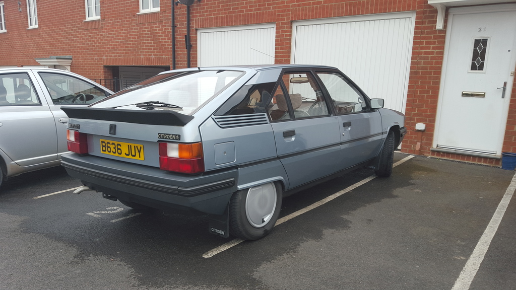

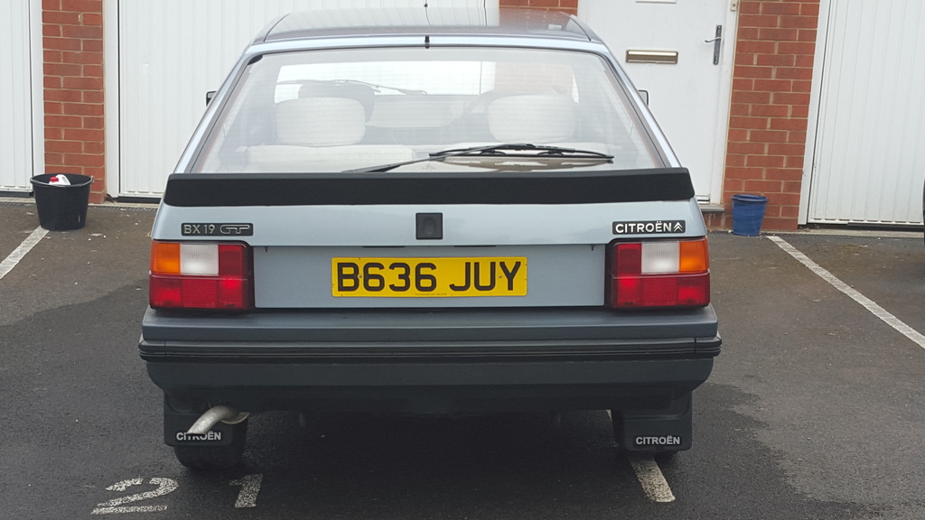

Here her GTness is at home, just had her pre-ball clean.
The gauge, Rich put a green LED in too, so it matches the dash! Forgot to take night time pictures with it lit up.

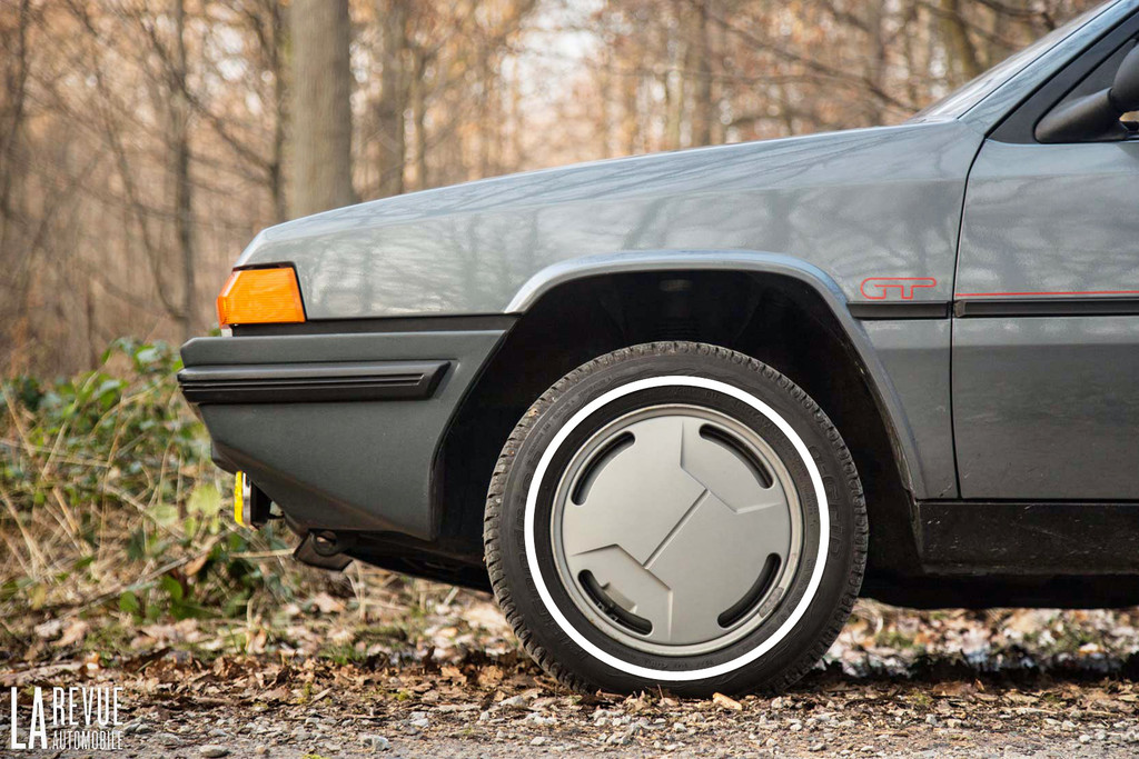

Just a quick edited image to show the white wall idea, im sure there will be those that aren't keen but each to their own. Im really keen on the idea especially with when the steelies and wheel trims are refurbished and are a nice bight silver (brighter or certainly a different shade than those in the picture I think)

I like the white walls with the original trims.

Always wanted white walls on a car, need to get the steelies refurbed before, and new tyres too - which'll have to be post challenge, and after my funds have recovered. We have a broken boiler AND washing machine, not to mention the work done on the GT!
