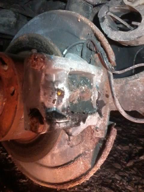

Well it failed :( Ruining my 100% record this year! But the good news is that all it failed on is the rear brakes not working enough. Took a wheel off this evening and found this:
The pads had rusted solid into the caliper, but a quick clean up had them moving freely again. Retest on Monday, so should be road legal soon.
And....it passed! Actually just in time for the MOT running out on the red one. I'm sure it'll appreciate the rest, as it's done about 2500 miles in the last few weeks.
