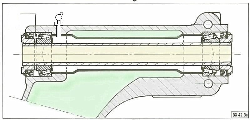

Realise this topic has had a caning, but a thought occurred...
If aim is to be able to deliver either grease (or heavy oil) into contact with the OE-type bearings, would the above fairly straightforward mod do it?
- drill and thread a hole through outer casing and through the plastic spacer tube
- insert a drilled-out bolt; this would keep the plastic spacer in position and prevent it from rotating
- screw a grease nipple into the hollow bolt
This would seem to be able to deliver grease/oil to the right place.
Unsure of exact direction of position of the added widgets, to allow access to the nipple.
BTW, did anyone ever find sealed SKF bearings that would fit this job?
(I hope Vanny might not mind too much that I used his coloured diagram again...)

Re: Replacing Rear Arm Bearings
Yes, that's similar to what's done in my 4x4. Good thinking, this is a simple way to do it!
RobC
- Posts: 596
- Location: East London
- x 30
The late AlanS of this parish used to advocate the grease nipple approach. I was never convinced that his design got past the issue of the plastic sleeve blocking the grease though. Yours does.
However I’d say there might be a danger of swarf getting into the bearings unless this mod is done with everything stripped down..?
The plastic tubes on the Mini were not very successful, they easily collapsed and the radius arm ended up full of grease. Earlier cars has a steel (or maybe aluminium) tube which worked a lot better.
Defender110 wrote: Sat Aug 10, 2013 10:12 pm Yes I have fitted grease nipples to my TZD but it isn't straight forward. You need to get grease through into the middle of the spacer tube and fill this with grease which spreads to the outer bearings. If you just drill the outer drop arm and fit a nipple the grease just fills the arm and does not get to the bearings. To solve this problem I drilled straight through the drop arm casing in the centre of the arm and then carried on through the spacer tube. I then tapped the outer drop arm to allow a grease nipple to be screwed in. Before fitting the nipple i fitted a small tube cut to the right length to allow the tube to be trapped between the tightened nipple and the spacer tube which allows the grease to travel through the tube into the spacer instead of leaking straight off into the hollow arm.
Could be much the same arrangement as the hollow bolt suggested.
Without a drawing, I think we were guessing where your small plastic tube went.
Did any suitable SKF (etc) sealed bearings ever get found?
