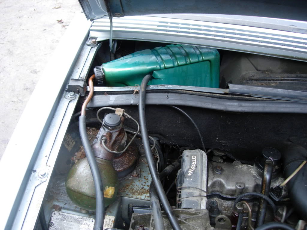

Moved the old girl this morning, started up easily athough sounded like a tank as the exhaust is shot. There is a bodge under the bonnet to supply fuel as nothing is coming from the tank but it shows a quarter full.

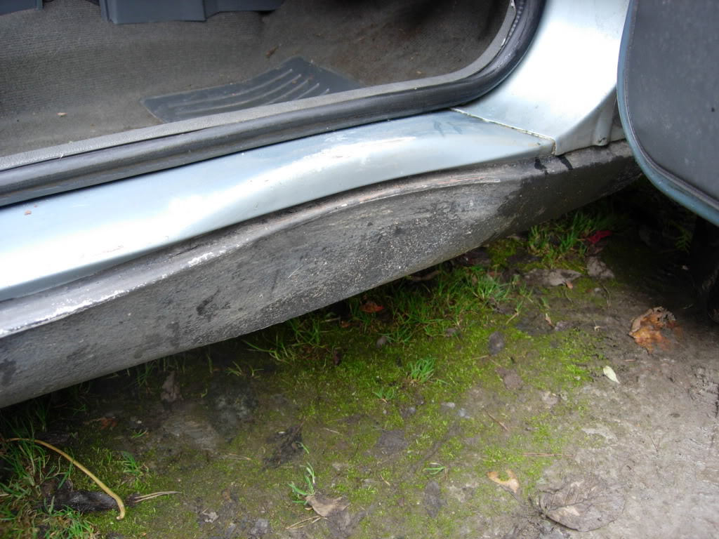

I am coming to the conclusion that she should be saved as i cant find any serious rust anywhere other than the doors.I also think the dent in the sill could possibly be pulled. what do you think Malcolm?

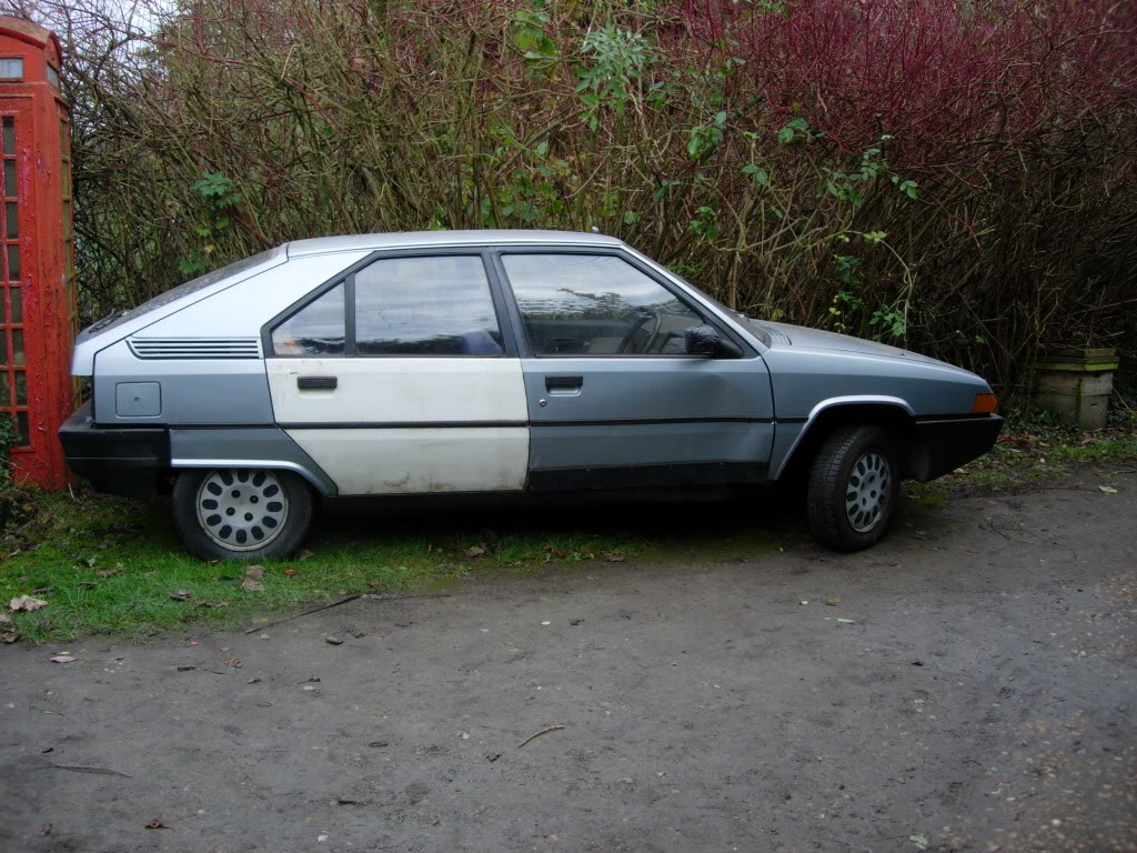

As for a name, well, the first piccy has blanked out the word 'collected' hence 'Colle'.
However perhaps that should be her name then.

That sill dent looks very similar to Timex's - I plan to have a go with a slide hammer to pull it out, and failing that there are sill panels on Ebay, or I'll make my own section to replace the damage.
Love the temporary fuel tank by the way!

well i tried a slide hammer on my door sill in a few place's, but as the sill is quite heavy gauge metal, it did pull a bit out but mostly it just pulled clean out of the sill,Mothman wrote: what do you think Malcolm?
so i am going to cut it open subtly straighten it and weld it back together,
but the dent to Colle's sill if you go that route it will be best to salvage a section from the scrapper,
