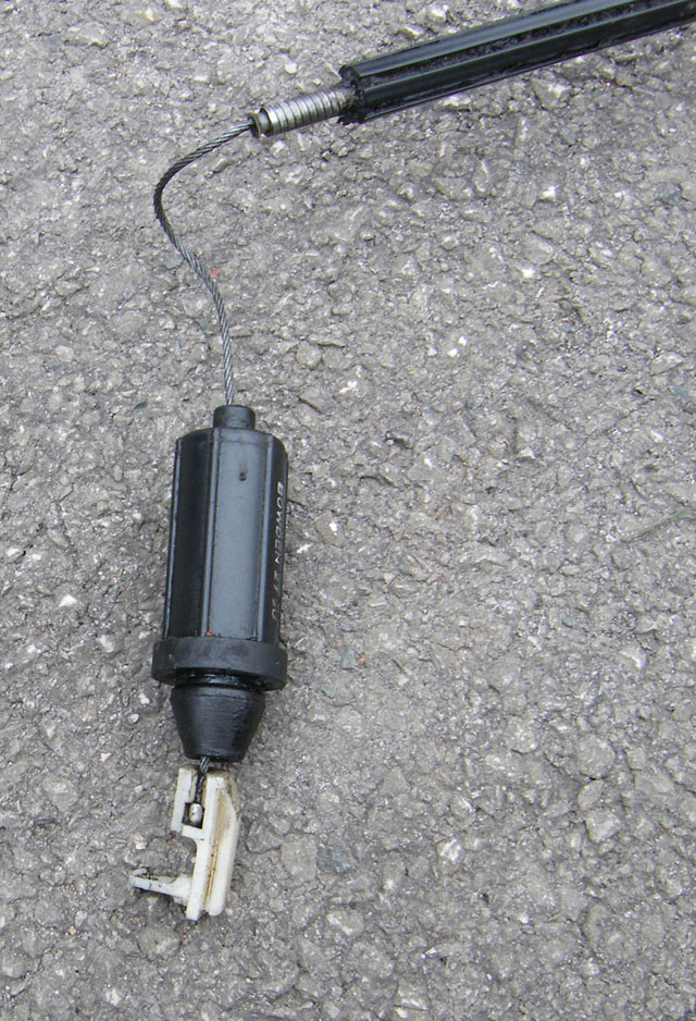

Hah, well I went to go out to put some fuel in and the clip on the throttle cable snapped the other tine off, which I was expecting but was hoping it'd at least wait until after I'd got fuel, didn't even get as far as moving the car before it went. I'll get a new one tomorrow, if there's one in stock at my local supplier.

It's also shared with 205s and I would imagine many other PSA cars of that era, if you get stuck finding one. Whenever I've had a leaking washer bottle it's been from the grommet to seal the pump to the bottle. Simply re-seating it has done the trick!

I'll do what I did with the Princess - ended up using a Peugeot 106 or a 1007 or something cable for that - and take the old one in with me to get the nearest match if they haven't got a BX one on the shelf. Autosupplies are usually pretty good on parts and they tend to not be too pricey.

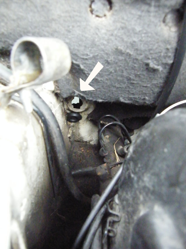

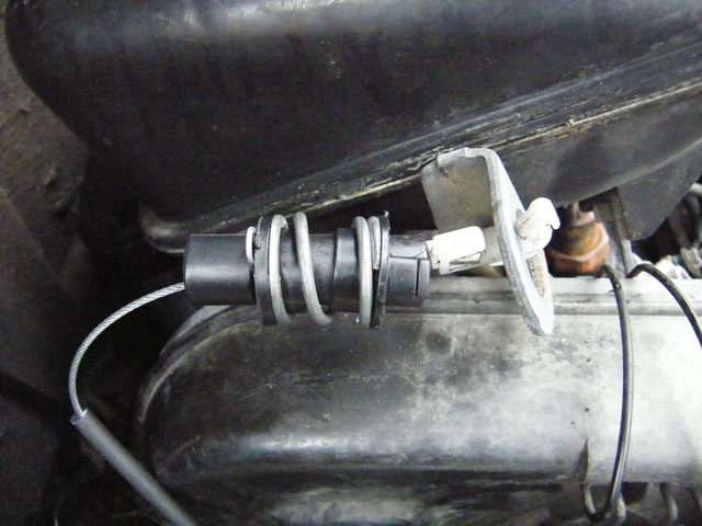

Went out and got a new throttle cable today, the pedal moves without stiffness and driving the car feels completely different to with the old cable. I'd say that's a good thing. I don't understand why they had to change from the simple old design as below...
...to this new design which came with no instructions and made a five minute job into a half hour job whilst Dad and I figured out how it should work.
You have to line up the tabs, compressing the spring to do so, push it through the hole in the bulkhead and then twist it to lock it in place. I'm not looking forward to ever having to remove it. Other than that, it was a very easy thing to fit really.
