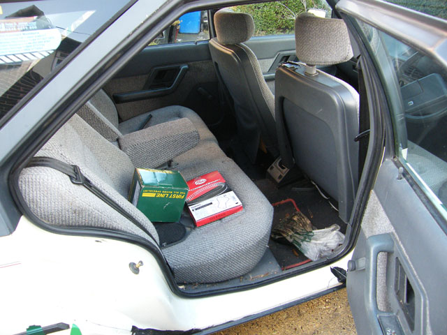

The driver's seat, as is normal, has seen better days. It's still comfortable and works, but the plastic trim and head restraint are broken, I need to look into how to fix them. This is just how the car was before I got cleaning and really, apart from storage mould and a bit of tree scaff, it's not that bad and should clean up very easily.

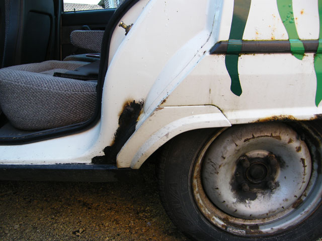

This is the only bit of extra rust I've found on the car and it looks far worse than it is thanks to it being wet and on white paint.

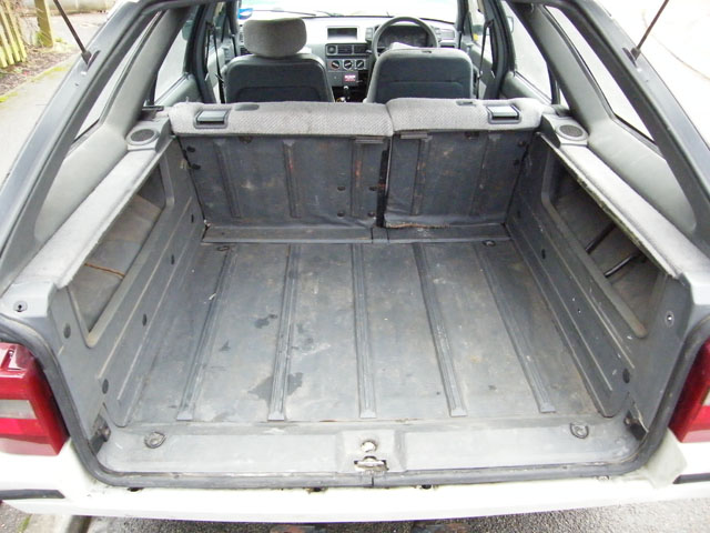

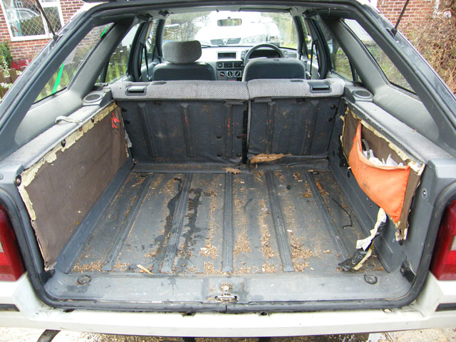

The luggage area is vast, and full of bits of tree...
... or it was, at any rate. Took only a few minutes to vacuum it out. I removed the improvised covers from the sides too, it all looks very tidy and should just need a quick scrub to freshen up.

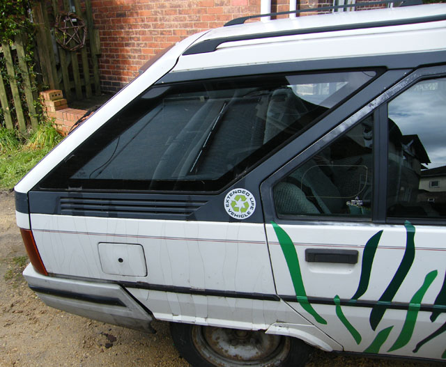

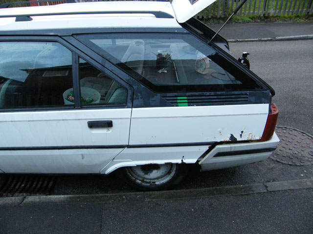

After I'd had a bit of a poke about I got on with destriping. The stripes are making a reappearance in the future, but I'm keeping just how I'm doing that under my hat for now. I moved the extended life sticker from the window to the rear pillar, looked tidier and I like it as a sticker. Completely decluttered the rear window too.

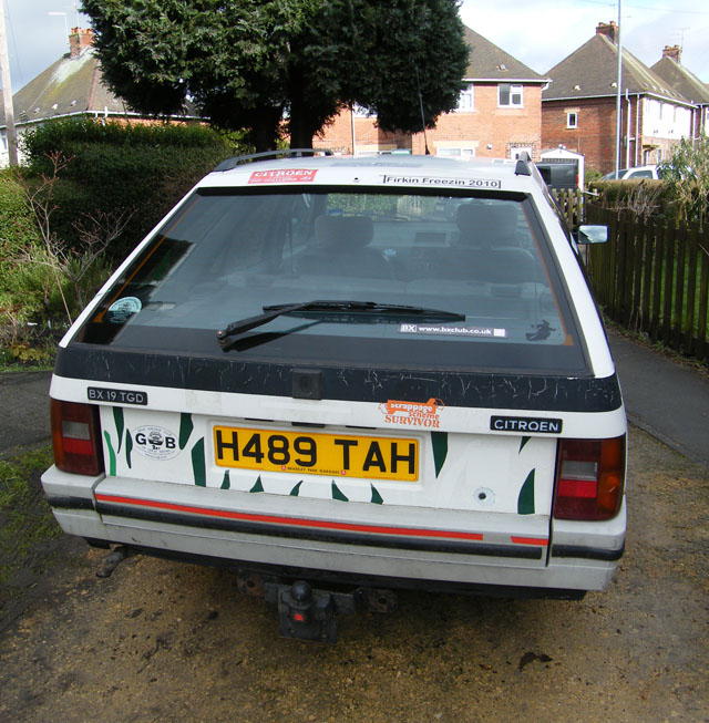

Made a start cleaning up the rear end too, mostly just a declutter of the glass. I've kept one or two stickers like the witch on a broom and the Vehicle Watch sticker, but the rest will go.

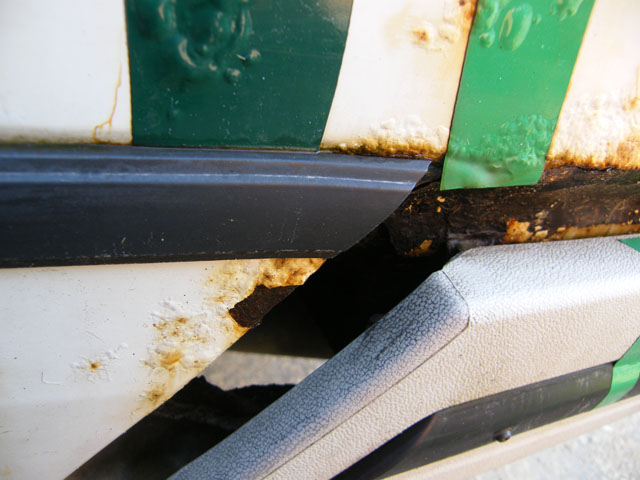

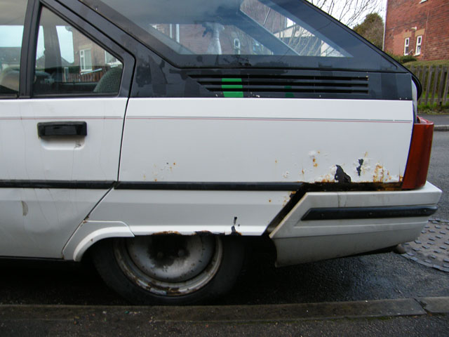

I was, of course, putting off the inevitable which is to investigate that rear corner, the worst spot on the car. Not as bad as feared, actually, there's still enough metal for the bumper to hang on. It also looks far worse because of the colour and the vinyl.
The rest of the spat is fairly solid too, just needs a tickle with a flapwheel and some fresh paint.

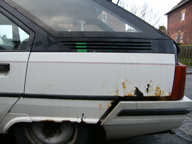

It's hard work removing the stripes, mainly because they were put on quite well, so I haven't removed everything. I did get enough stripes off to get on with tidying up that crusty rear arch.
After a clean, I tried just using a clay bar to get the paint uniform and remove the shiny-matt finish from the stripes being on for so long.
Instead, I got the Farecla G3 cutting compound out and tackled the panel with that. Much of the rust staining disappeared, as did the ghost of the stripes.
Another attack with the clay bar after this gave me much better results.
A final go over with the Farecla G3 to bring up a bit of shine revealed a panel that isn't anywhere near as bad as it initially looked.
