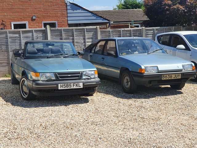

The BXs in their new home, once Steve's autlntie is home from visiting her son and new grandson, the GT will go in the garage and the TRS under the weatherproof cover.

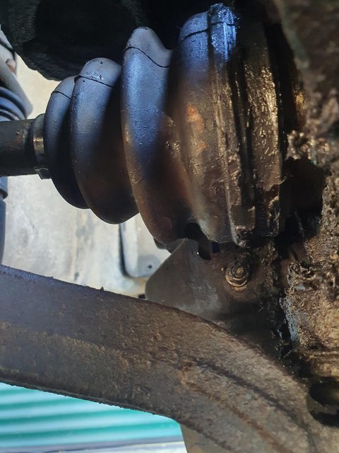

CV boot - the outer drivers side CV boot was loose! The retaining clip had come off at some point, it must have been recent as there wasn't much escaped grease. I asked the MOT garage to attach a new clip on the re-inspection.

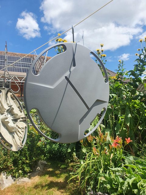

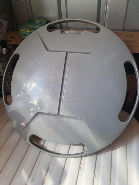

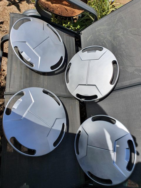

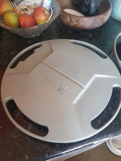

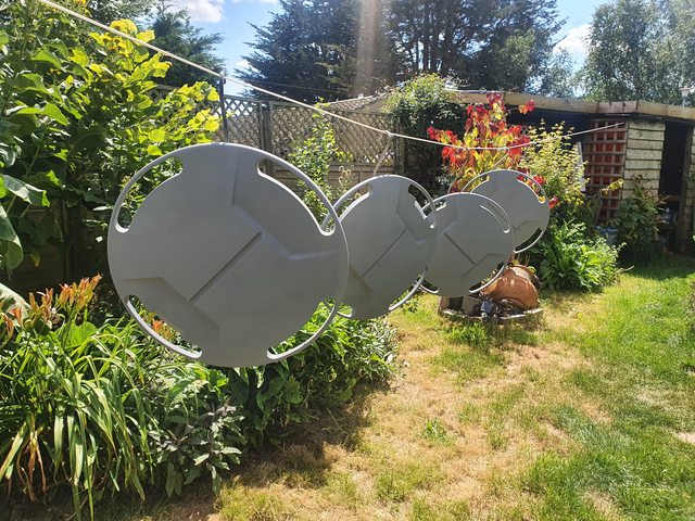

Today's efforts were wheel trims in prep for the classic show on Sunday, i'm not 'showing' the GT but I will arrive in style! As mentioned above, the wheel trims were oily, dirty and quite scratched. Unfortunately whilst scrubbing them with a scourer pad, the paint was being scrubbed off! So I thought i'd do a quick paint and freshen up whilst doing other things. I know you're supposed to leave primer overnight to dry before putting the top coat on, and the uneven finish may well have something to do with that - but this was supposed to be a very quick freshen up, so much so I didn't sand anything other than to roughen up the trims for the primer.
Dirty
Clean
2 coats of primer (wet)
3rd coat of primer (wet)
3 coats of "Vauxhall Star Silver metallic"
Although they aren't completely dry, I think it is going to be a patchy finish, ho hum. When it comes to more cosmetic stuff on the GT i'll use some hi-build primer to fill in the scratches etc, rub them down properly between each layer and use a lacquer top coat as well. For now, I think they're much better, i'll get some photo's with them on the car tomorrow when I wash it. The colour choice was semi-intentional as I remember restoring the grill on my 1991 MK2 Astra years ago and liked how bright the colour was then.
Dirty
Clean
