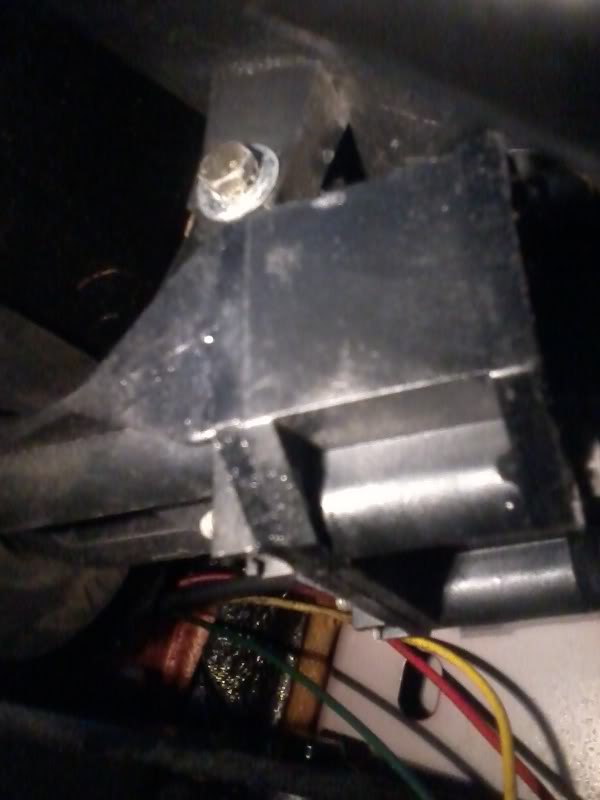

It's great to be driving it again, but a small problem has crept in over winter. The blower motors will intermittently cut out, especially when on full speed (transistor bypassed). Running a temporary good earth to terminal 3 of the speed control PCB in the dash restore correct operation, so looks like the common fault of a high resistance earth connection.
I have to confess when I've fixed this fault before for others I've simply run a supplementary earth lead to the earthing point under the passenger seat, rather than cure. (The car's owners were happy with a quick fix, but with it being my own car now I'd rather find the problem and sort it if possible). I believe the original earthing point is on the steering column, but will try and trace the wire later today and see what I find. It would seem strange that a connection in the car has suffered from corrosion though... :?

Just tried to investigate the earth wires but without taking off the dash I can't trace them. They don't go to the earth point on the steering column (as the Haynes states), as that is clean and the blowers still work even when that's removed.
The only other earthing point it could be is m4, described as being 'behind console' and I'm not sure where that is. So I'll just add an extra earth wire for now, and if I ever take the dash out again I'll investigate further then.
mat_fenwick wrote: but with it being my own car now I'd rather find the problem and sort it if possible). I believe the original earthing point is on the steering column, but will try and trace the wire later today and see what I find. It would seem strange that a connection in the car has suffered from corrosion though... :?
Yes same as, I have coupled the earth link for the motor to the lighting earth lug but would like to find where the original has shorted out. I assume it is the earthing coneector that has burnt out due to ampage and assume the new temporary earth will eventually do the same??
Perhaps we could send them back into Citroen under warranty as it is obviously a common weak point :lol: :wink:
It doesn't have to carry a high current, as all it does is carry the small switching current from the transistor. It does join up with the main earth from the motor(s) though before going to an earthing point somewhere, and my guess is it joins up at the connector to the transistor PCB in the blower housing. That would make sense, both for where the wire appears to lead and also why corrosion/high resistance would be a problem.
What I've done is link to the lighting earth on the blower control PCB - but what puzzles me is why Citroen had 2 separate earth paths. It looks like the original PCB design linked the 2 earths, but the track has then been drilled through to break the link (presumably cheaper than changing the etching). They must have had a reason to do this, but I can't see why!
Anyway, it's working now, with no apparent ill effects.
