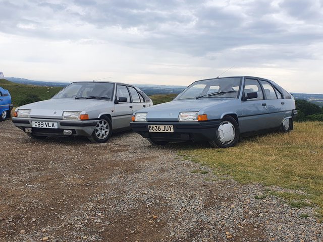

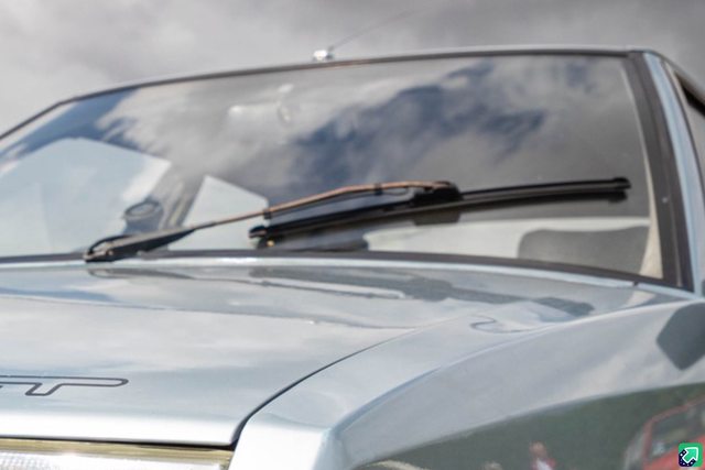

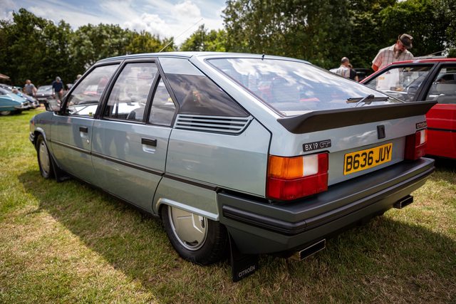

The GT has been busy since it's MOT, with both the Gilke's Café 40th and CCC 40th it attended. I had a great time at both and it was really nice to meet up with friends I hadn't seen for a long time and to meet some new ones too! Of course there were plenty of BX's and other Citroens to perv at as well, if you feel you've missed out there are loads of very good photo's on the facebook group
(some of these pics were posted by others on the FB group - if they are yours and you're not happy with my theft then please let me know!)
