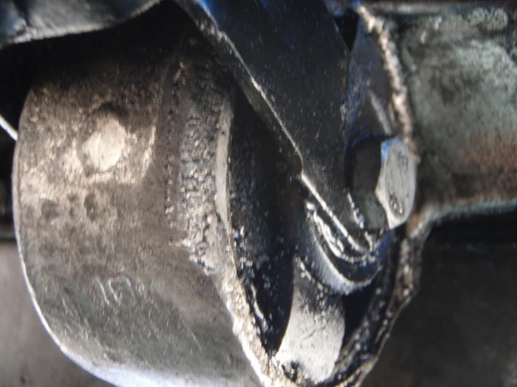

There were some interesting things I saw under the car. This is the rear engine mount, with a chunck taken off!

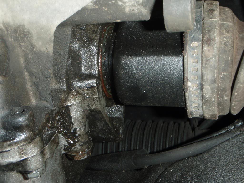

Looking up behind the engine, can't quite see the power steering rack, but this is where LHM is dripping, can't see from where but it ends up on the coiled pipes and the pipe with the union in this picture.

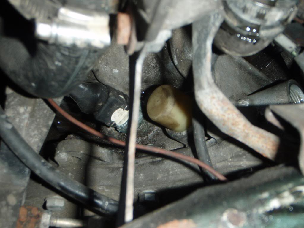

What's the creamy plastic bit here? Can also see the water leak in this picture, juts needs a new jubilee clip I hope, or maybe a new hose.

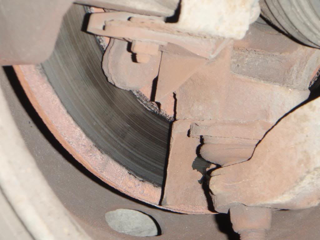

Drivers side brake disc from behind, there's a wear ridge, and the pad must be worn to not be using the full depth of the disc.
Passenger side looks much better!
