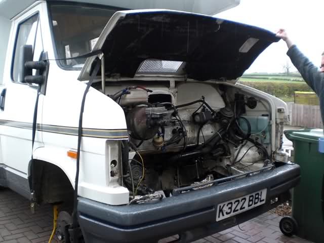

Post by DLM »
Oh well, hopefully resurrection is at hand....

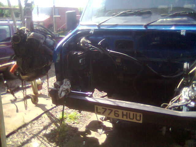

Post by DavidRutherford »
That's a faimilar sight.

Post by Ian_Fearn »
David, is that a 2.5 NAD?
