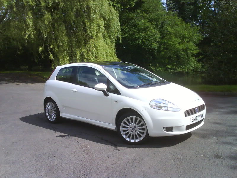

well this is my Punto...to be honest I have never stuck to 1 brand of car, I have had allsorts so I know what I like and what I dont, and I love the BX, but im never going to say its as 'good' to drive as a modern hatchback, more interesting yes definately, more fun also yes in my opinion, but cornering, steering, roadholding and refinement are all of course better in the Punto. Plus with modern cars you get safety, reliability, toys to play with but unfortunately no character to speak of, although im going out on a limb and saying the Punto is better in that respect than a Fiesta, Corsa, Clio etc etc.
P.S, I still think the F.ord Sierra Sapphire is the best car ever made lol
