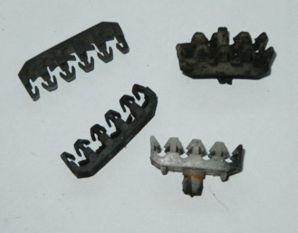

I noticed all the pipes are clipped together at various points by a plastic clip thing that seems to go all the way round the pipe. How do you get pipes out of those? does the plastic bit open up some how?
I don't want to break any of the other pipes trying to get that one out.

I must have been looking at the underside of one of those clips, so all I could see was the flat bit so I couldn't see how they come out; Now I can see they must come out the other side. ,
probably not as the later BX's did/do have a diferant sort of clip, which has two parts, one part is fitted to the body/chassis rail which the pipes lay into, then the other part has two pegs which locate into holes in the firts part and over the pipes, to remove this type very gently prize the outer part away so not to snap its pegs off,
i did draw the pipe layout a good few years ago but have not fitted a hole set of pipes for quite some time now,
but if they are as they were originaly fitted they lay in the same order the length of the car

ps.
out of all the many sets of pipes i have replaced over the years, i have seen more pipes needing replaceing as a direct result of damage through shaffing than i have pipes just splitting open at the seems
