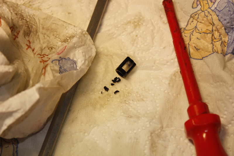

"s'OK dave....... Ah, fixed it.."
So I whipped the FDv out one last time as the red light would not go out and the car wouldn't lift up unless you moved the fully operable PAS to full lock and held it.
I noticed that when in it's phase of not letting the light go out and not rising up that if I pushed one of the end caps of the FDV in against its spring it madd a hiss and sprang to life but it would again go back into the bad cycle in short time.
I dismantled it and removed the main slide valve and fixed the spring. I found that the nylon inlet filter I'd only cleaned about 3-4 months ago was again full of black crap!
Turns out to be lots of little chunks of black rubber.
I cleaned these out and inspected the inside of the FDV - there were wee bits in there too! indeed there were two lumps that were in a position to easly cause the slide valve to jam due to the super fine fit of the valve. I spent a long time cleaning this all. Once I was happy I reassembled and meticulously checked the cleanliness of the bits going in. Also reset the spring to its original 32mm length and made sure it was totally straight.
I checked the second filter and it was clear.
Refitted in the car, got running and tightened the 12mm regulator bolt and it pressureised and clicked as normal. The red light was out and wouldn't come back on even going from low to high and the PAS is fine - very light actually but it is on gravel.
So It's fixed.
I wanna know though: how is the PAS on other members' BXs. Is it super light while stationary? is there some resistance? how 'assisted' should the BX PAS actually feel?
So It's fixed.

- I am not certain. This filter is for the high pressure inlet directly from the pump.
There's a miro possibility that it came as a result of a pinched bit of the pipe seal when it was last fitted and ended up caught in the filter.
I want to know how some lttle bits got into the slide valve to jam it - the filters were in perfect condition - no holes and there is no other way into the FDV from the other pipes as they are all 'outie' pipes - the two 'innie' pipes both have a filter.
Not a clue
Not a clue
