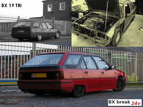

There is one - well, in the process of being made still, in Holland with a Xantia V6

i have read of a few v6 bx's about all of which were in europe . i think the biggest pain is the exhast manifold on the bulkhead or something i have looked into it and there is a company which makes exhaust manifolds for the v6 that goes into the 306 so could be used in the bx possibly. if a v6 xantia manual ever come up i would be wedging it in my bx lol
