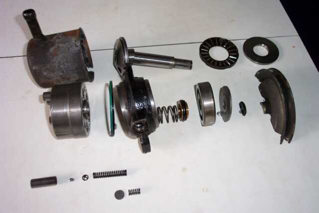

Hi Bob,
Great idea, I have thought and asked about this in the past, but it seems that no one (Unless someone knows different) has dismantled a BX pump without damaging.
I have on file an article by the late Bob Smith in Adobe format, but I can't load that to Photobucket, I do have one picture from that article as below.
He had to cut off the casing and pulley, as it seems they are heat shrunk on.
I have made a sphere pressure tester using an old pump, and this does allow the testing of each piston in turn, and thus a comparison can be made.
This is a good way to find if one or more pistons are faulty.
And if any are below par, then running flushing fluid through the pump over a period of time may improve their performance.
Brian
Brian

Hi Brian,Brian wrote:I have on file an article by the late Bob Smith in Adobe format, but I can't load that to Photobucket, I do have one picture from that article as below.
Brian
Thanks for that pic - that is amazingly useful. I finally have some clues.
I'll PM you my email address - if you would be so kind as to send me a copy of that PDF file, I'll use it to get up to some kind of speed on how these Staffa-motors-in-reverse come apart.
Great stuff! I'm kind've starting to have a good (read naive) feeling about this .....
Anyone care to donate a totally stuffed pump to this? I'll fund the postage. Preferably something that's beyond repair and doesnlt matter if it gets destroyed in the process?? (If it actually gets fixed in the process, we can all huddle around it, lay hands on the thing, and shout "Hallelujah" 'n stuff!)
