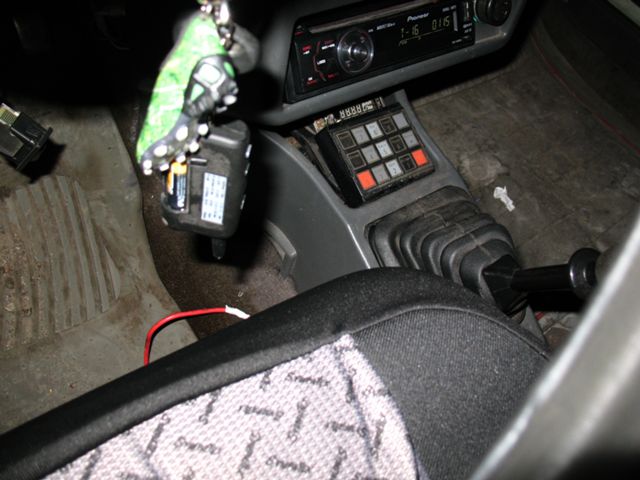

I have Citroen BX19 GT (mk1) 1985' and want to find any information about on-board computer
I can't find any info onour sites((( only Haynes:

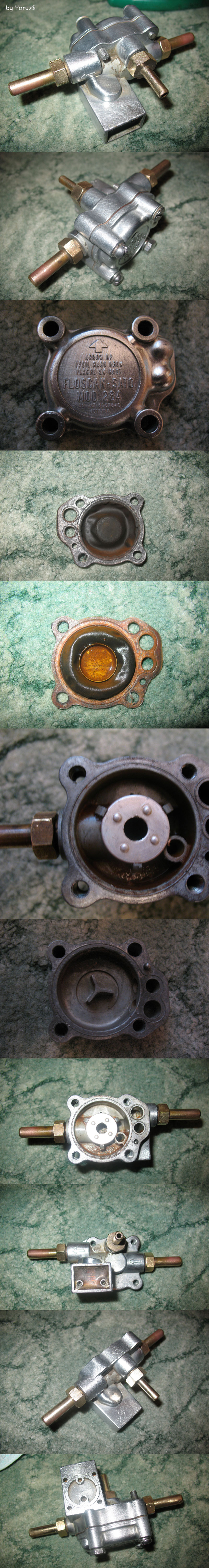

I have fuel output sensor under hood:
but it is disable(((
who can help me connect board computer? now it show only clock ((

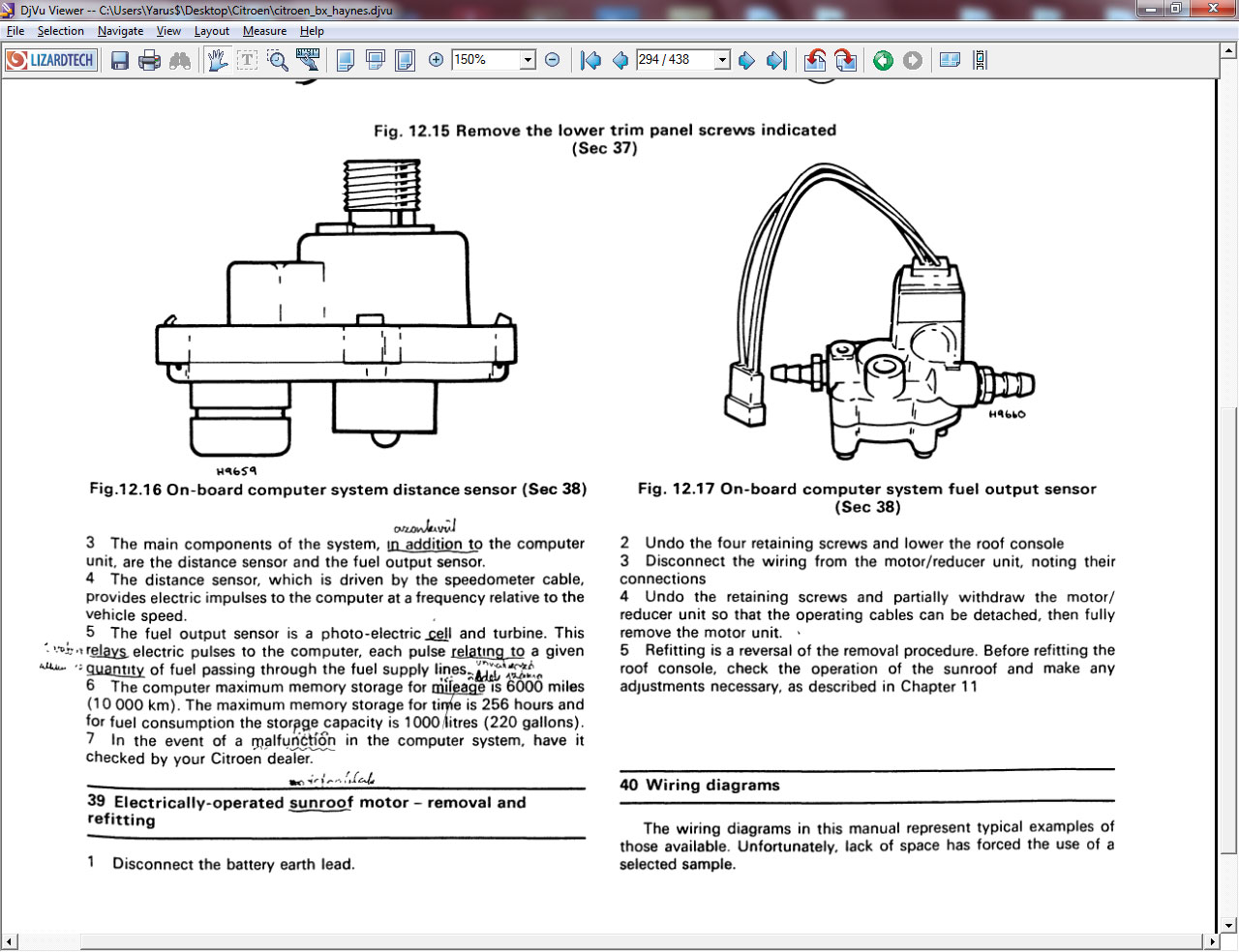

And where should be the distance sensor?

The distance sensor that you are looking for is to be found connected onto the speedometer cable, where the two halves are joined together.

And how must be connected output fuel sensor? there are 3 tubes...
