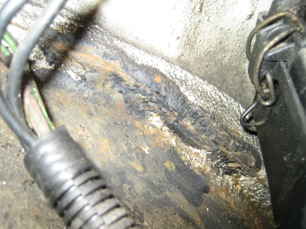

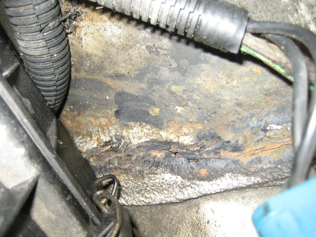

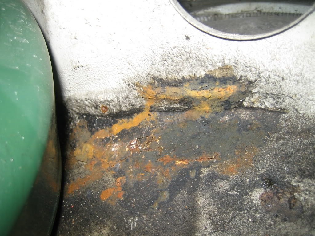

Piccies of the inner wings, what does anyone think?
DavidRutherford
- BX Digit man!
- Posts: 2706
That's quite a hefty amount of seam corrosion in the nearside inner wing. The offside isn't as bad, possibly 8"-10" of corrosion. The nearside I suspect will have a good 12"-14" of corrosion and will be a more complex repair (to do it properly)
That said, you may well have caught it early, so it'll only be the seam rather than extensive panel corrosion. No way to tell for sure until it's all pulled apart and the seam sealant all removed.
