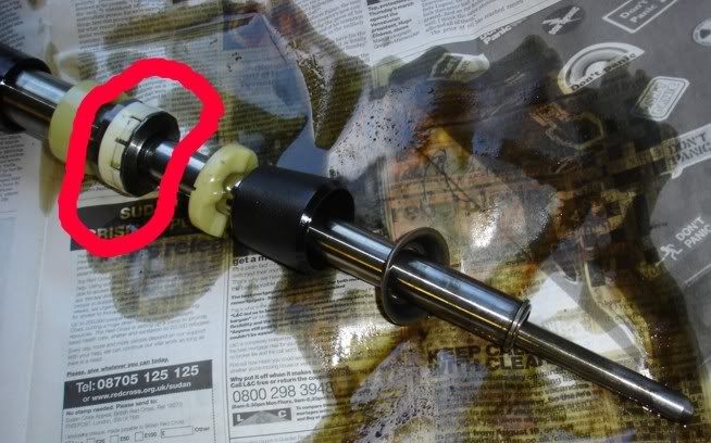

Heres a pic of the innards......
The castellated plastic bush wears as do the internal seals in that area.
I have the dimensions of these somewhere.
The inside piston, as Doc says, develops a wear groove and is a cause of the struts sticking in one position. This needs polishing out at recon time.
The thrust bearing at the top of the outer casing wears too, but mainly it dries out and responds well to lubrication. Theres a few o rings too to replace but these are probably quite easy to source.
