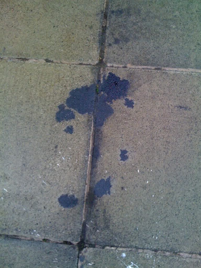

Anyway - after 5 days this is what is left in the driveway.
My mechanic had a look today. He thinks it may be the rocker seal which he will charge £80 for. But said it could possibly be the head gasket. The bad thing is I think he may be right. After topping up the oil, I checked the level on the dipstick, there looked to be streaks of water in it.
Has anybody had the head gasket done on their BX? How much did it skin you?
Anyway, he has told me to have the engine steam washed, then the exact trail of the oil will be apparent.

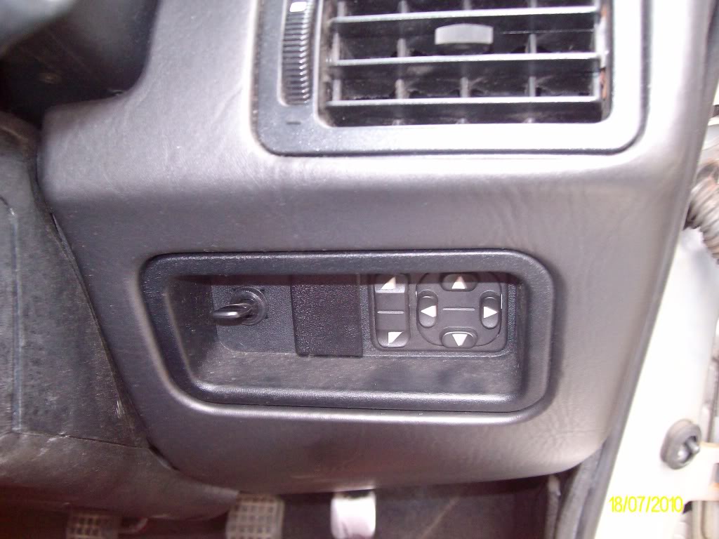

Have a look at this photo -
The toggle switch I'm guessing is for the front fog lights. However they do not work! Were front fogs standard on the TXD or are these aftermarket?
Now the controls beside that? Electric mirrors? This car has manually adjustable mirrors so what the hell is this for!?

I don't know about the switch on the right but the one on the left looks like a DIY job. Could be for front fog lights if they are aftermarket but could be pretty much anything. If you unscrew the ring thats holding it in then you can pull it out to check if its still got wires attatched and if they look familier / become live in combination with other things being switched on.

The buttons on the right control the passenger side mirror on mine (whereas the driver's side is manual).
There are several different types of head gasket failure.
Water in the oil & oil leaking externally are 2 different symptoms of head gasket failure that don't necessarily occur together so don't automatically connect the 2 as definate head gasket failure.
Although some engines leak oil via the head gasket when they do it is usually a slight slow dribble + I don't think BX diesels are prone to that problem.
Water in the oil can be the head gasket leaking between a water gallery and an oil gallery but streaks on the dipstick may just as easily be condensation in the oil often found on cars that are overdue an oil change and are only used for short distance journeys.
Combustion gases leaking into the cooling system causing the engine to pressurise and overheat is the big problem head gasket fault which I take it you haven't got.
So although I can't deffinately say your head gasket has not gone looking at the amount of oil it is more likely to be your rocker cover gasket that is leaking and perhaps an overdue oil change.
Just what I wanted to hear... I'm probably being pessimistic.
Also, £80 seems a little on the dear side for a £5 seal and half an hour's work...

Wooscary wrote:The buttons on the right control the passenger side mirror on mine (whereas the driver's side is manual).
That's interesting... it's exactly the same as the Series 1 XM door mirror switch, in which it does both door mirrors (the smaller rocker switch selects either mirror, with the centre position "off" so the mirrors don't get moved by accident.)
I thought it would do the same in the BX.. odd that it doesn't. Still, I have manual mirrors on my BX, so wouldn't know... :oops:

Ray, that switch does exactly as you've described in your xm as it does in the bx, but only if you have 2 electric mirrors fitted. I presume that in this case only one of the mirrors is electric & the other is manual??? This isn't standard fit in txd's as far as i'm aware, its in gti's, valvers & tzd turbo's & possibly the odd few ltd edition models with highspec??? Again, txd spec doesn't include front fogs, so must have been retrofitted as its not normally a switch, but a rather largish square button that from memory illuminates green in colour.

Yes, exactly. There is a rocker selector for choosing which mirror. Unless you have a great big handle on one of them, then you have to do it yourself. :)
The position of that switch for the fog lamps is interesting to note for me however as I have holes in my bumper which are just crying out for some retrofitting and wasn't sure where the switch might be best.
Ray, the XM switch is very similar (looks identical) but if plugged into a BX with twin electric mirrors will operate them with reverse logic (tilt up when you press down)
The switch fitted to single electric mirror BXs will not operate two mirrors without some internal modifications (fiddly but possible).

mat_fenwick wrote:Ray, the XM switch is very similar (looks identical) but if plugged into a BX with twin electric mirrors will operate them with reverse logic (tilt up when you press down).
Isn't that what we'd expect from Citroen? ;)

My TZD has exactly that arrangement for the mirrors - the switch is the same as the one on my old ZX, which had \'leccy mirrors both sides, but the BX has a manual mirror for the driver and an electric one for the passenger side. It makes perfect sense, as an arrangement, but it\'s a shame they left the selector switch in place! I\'d have just left it out, rather than having a pointless and slightly confusing switch there.
I would say so! This item is easily sourced from the likes of GSf and Euro carparts, and its an easy job.
This item is the number 1 source of oil leaks on these engines (due to the gasket going hard over time), just be sure to put a new one on with a smear of silicon sealer as I have even seen new gaskets leak, also be sure to check that the fibre washers are still present on the cam cover holding down bolts, as these are another oil leak source.
If after this the oil leak persists the next likely candidates are the cam oil seals or timing belt end crank seal, the non timing belt end of the camshaft is an easy change. However the timing belt end is best done when you change a timing belt.

stuart_hedges wrote:it\'s a shame they left the selector switch in place! I\'d have just left it out, rather than having a pointless and slightly confusing switch there.
True, but then they'd have to use a different switch, and that costs more money :)
