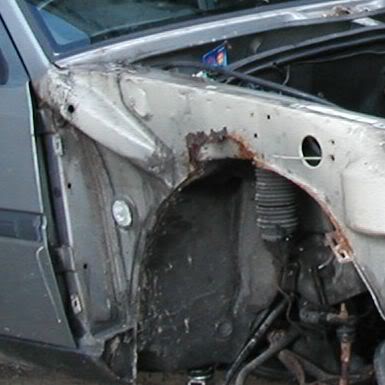

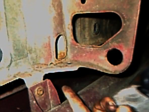

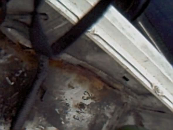

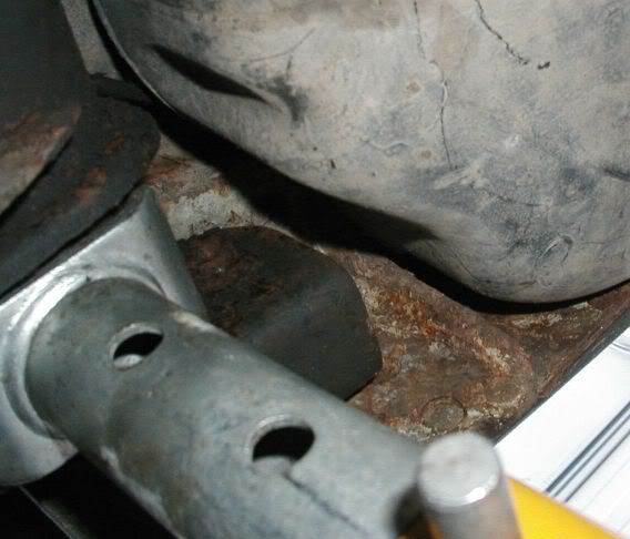

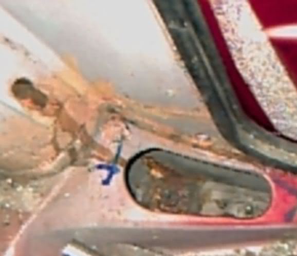

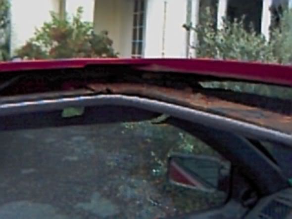

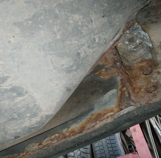

Most specifically rust. BXs seem well protected in relation to other cars of the same era, but look out for inner wings, A posts around the door hinges (they can also crack in this area), bottom of the C post, sills, and boot floor (especially on the hatchback).

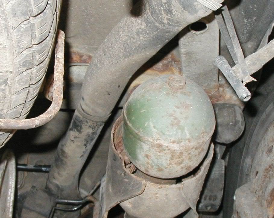

The rear suspension struts can corrode though and cause a high pressure LHM leak, especially on estates where the strut walls are thinner due to the larger piston diameter.
