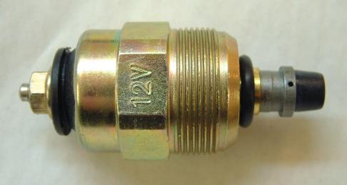

This isn't the same stop solenoid, but you can clearly see the plug seal on the far right hand side. That's what's failed on mine. It must be there somewhere!
You can check if the solenoid is functioning by crossing a 12v source between the body and the threaded electrical connector. Mine was working fine.

Well I bought a new stop solenoid and it doesn't appear to work, when you say i can cross a 12v source to check it what is the easiest way to do this?? (I know i'm stupid but the kids go back tomorrow so hopefully my brain will start functioning again then LOL)
also old stop solenoid had a spring down the middle of the plunger, new one seems to have a spring across the top of the inside where the plunger goes, if that makes sense????? is that right?
thanks again guys, at least I only have to pop the bonnet open to stop it now (old solenoid back in) way way more cool than stalling :)

Refering to Ritmo's pic - the casing - the bit with the screw thead and the hex section marked 12v is ground / 0v / chassis - take that to the negative of the battery with a piece of spare wire.
With another piece of spare wire connect the positive of the battery to the far left hand side on the pic - where you'd normally attach the wire in the car.
When you do that - the plunger on the right hand side of the pic should be pulled smartly back into the body of the solenoid - if it does that then it's working ok.
Try not to touch any part of the solenoid while you are doing this - it's an inductance - a coil - and similar to the coil that causes a spark in those strange petrol engine thingys there will be a high voltage for an instant across the solenoid.
