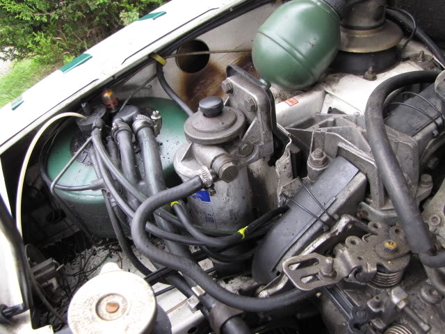

Below is the fuel filter. Advice appreciated on water draining.

You should find a plastic screw on the bottom of the fuel filter - loosen that and water/diesel should run out. If you collect it in a container you will be able to see the water and diesel as separate layers. You may need to prime the filter with the rubber button on the top afterwards...
The amount of water seems to vary considerably, I guess depending on temperature (condensing on the tank walls at the petrol station?) and the quality of the fuel. At least you have the earlier filter housing, that is better for trapping any water that may be in there...
