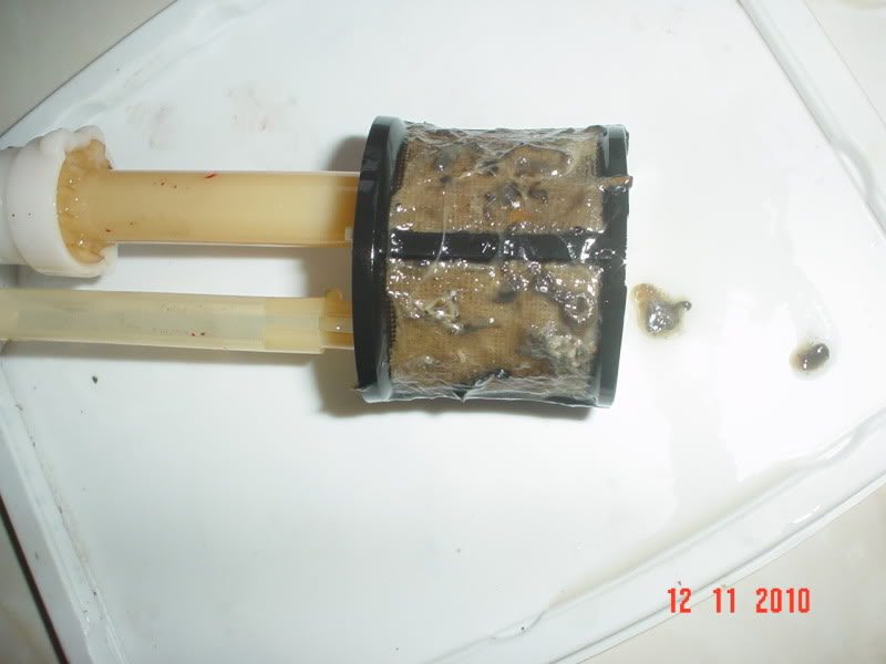

There is also the possibility of sludge in the tank. A couple of years ago I had similar issues and went through the whole list as above with no change. It was Doc that suggested I should 'go fishing' in the tank.
When I opened the tank cover, straightaway I saw that the filter on the fuel pick-up was sludged up. Then there were quite a few 'jellyfish' floating in the tank which I fished out. That cured the problem.

Todd's post rang a bell, if its not sludge it could be fungus in the tank, it can be sorted with some appropriate fungus remover (I've got some). Whereabouts are you? If you're local to me then you can have some for nowt.

eeeeeeeuw
That looks nasty, slime & fungus. Was there any sign of this in the fuel filter? When mine got blocked by duff biodiesel, it was like sticky golden syrup that enveloped the tank filter which then pretty much blocked off the fuel going to the pump, hence total lack of power & it would just stall eventually....

I'd be looking at Todds suggestion now.
toddao wrote:There is also the possibility of sludge in the tank. A couple of years ago I had similar issues and went through the whole list as above with no change. It was Doc that suggested I should 'go fishing' in the tank.
I must also mention that Kermit very kindly gave me one of his custom made tank cover opening tools!
