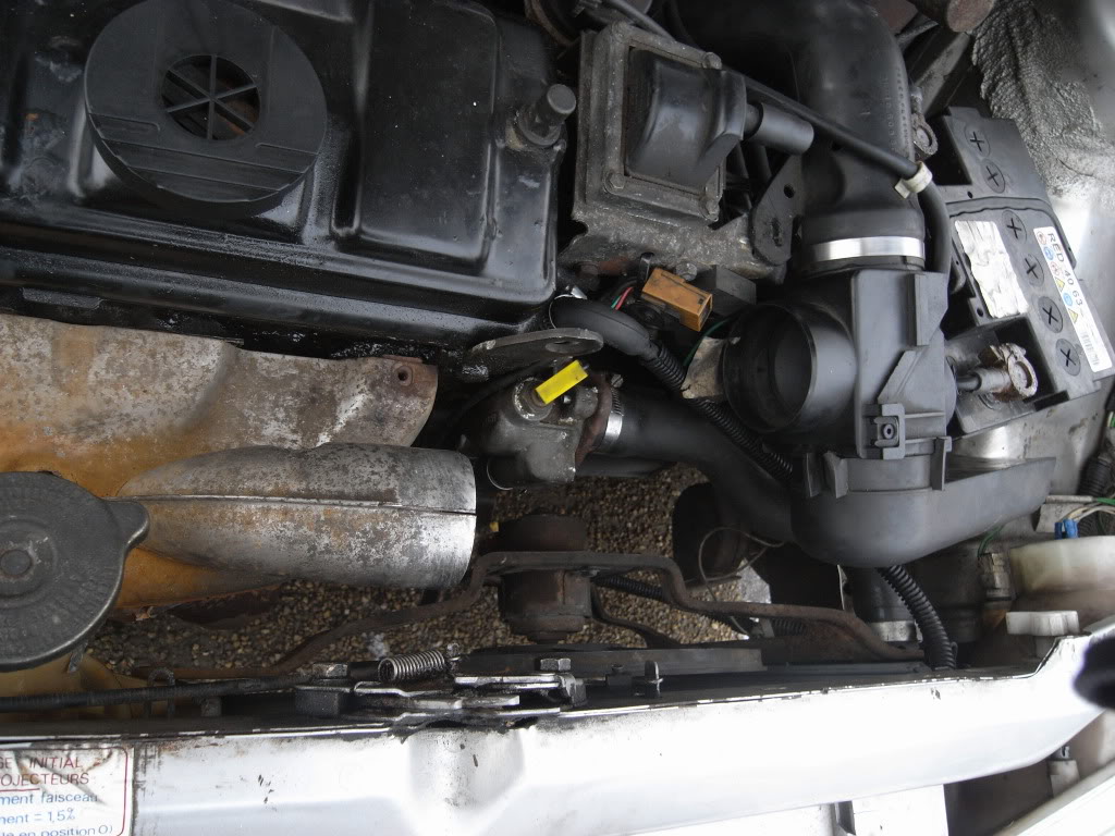

The temp sender on the AX GT is in mounted in the top of the thermostat housing. I had to find a new housing for mine, and walking round the scrap yard, it looked like every TU engined Pug and Citroen had the capacity for the sender. The yellow plug below is where it lives:
This was off a Xsara and was identical!

Ahhh handy picture,
what i meant by my BX has the sender, well, where the yellow spade terminal is in the pic. Thats where i have the sender unit but no wiring or gauge.
So, in theory all i need is to connect it up, hey presto.
If citroen fitted the sender but not the rest of the kit to mine, they possibly did to a lot of other vehicles too.
