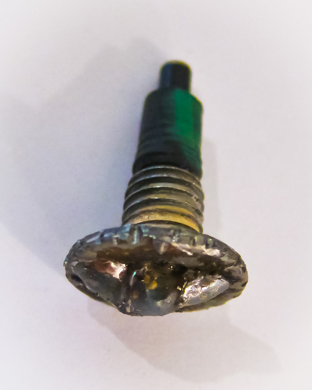

I sorted the pesky broken stud out this arvo. This was the solution, I found it on line for €15 - 'BGS' Stud extractor - waited four days for it to arrive and today applied it. It's really a good thing, I thought the stud had broken again but it had turned once this thing gripped. Good for broken studs/bolts from 6mm-18mm. Merc is now back on the road..
