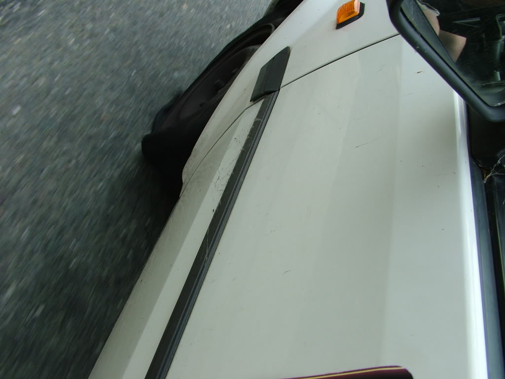

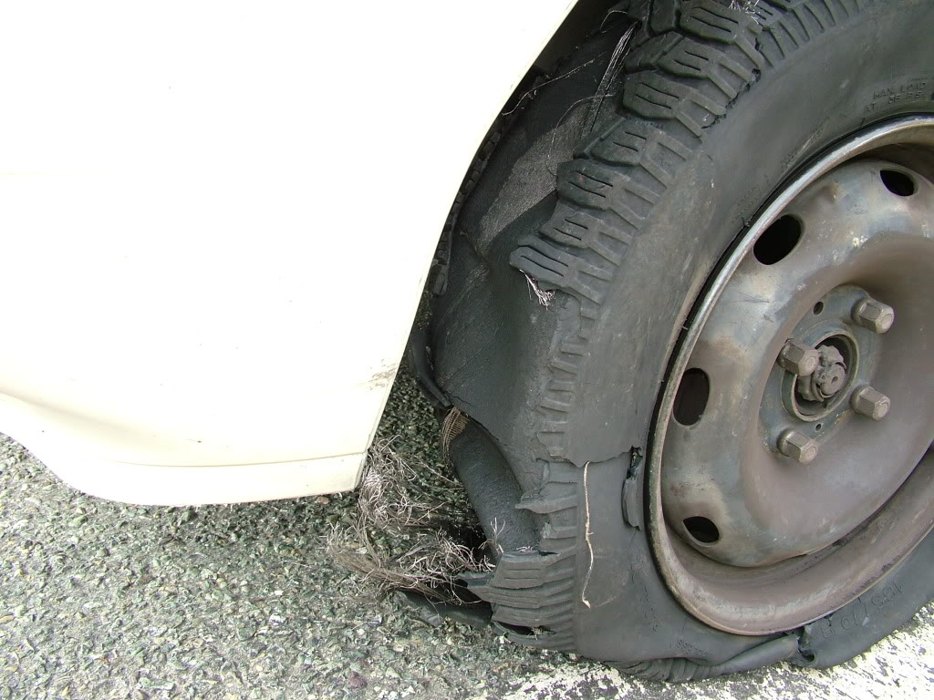

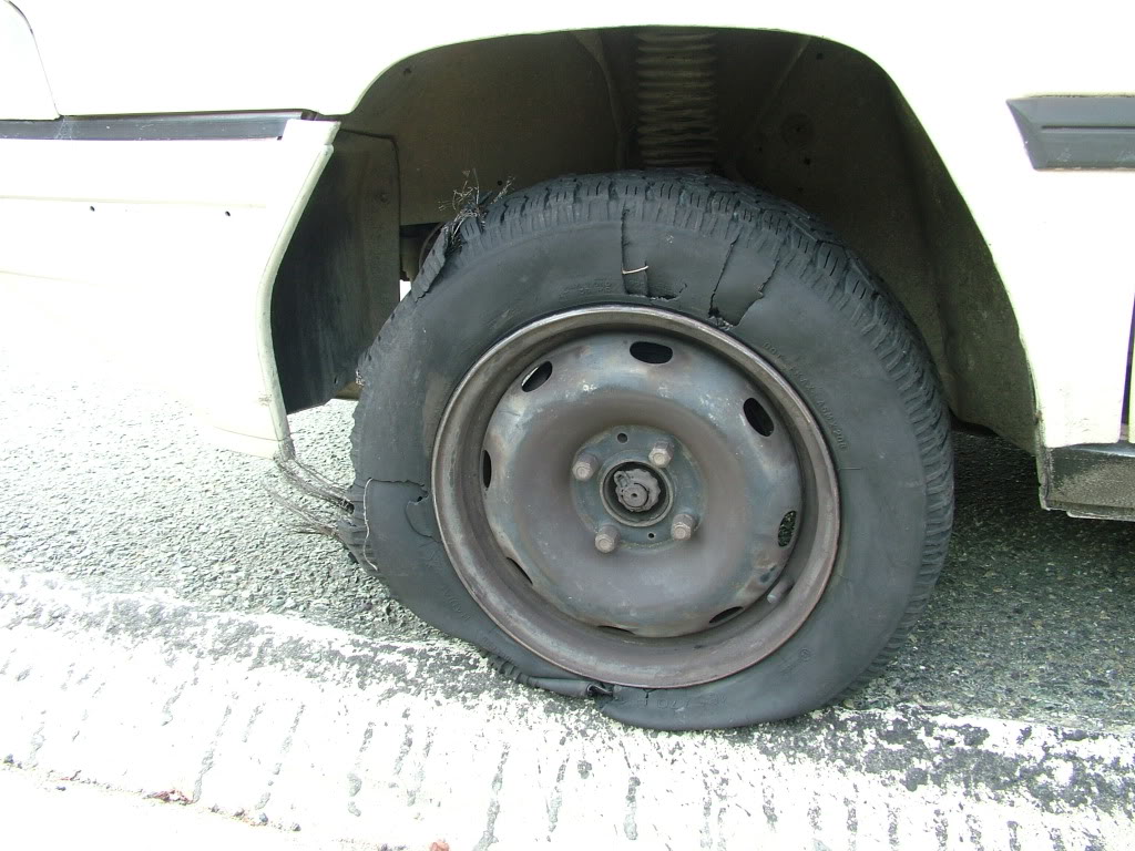

Coming over a hill and round a bend at 100kph tyre just decided to disintergrate. nearly tore the wing off. ripped the wheel arch lining out. i am pissed off with the michelins they are usually so good.

That tyre looks remarkably like an MXV and therefore about 20 years old (most of us still have them under our cars as spares)... so in all fairness, not too surprising that 1. It blew in the first place - & - 2. It delaminated and discintegrated so badly...
If it is indeed the MXV it looks then this should pose as a stark warning to anyone tempted to use one of those "brand new and unused" spares!
Thats not an MXV its a MXL! which is even older. Probably a good 25 years old? :

Agreed, whilst these tyres were very good, I found as they got older they easily developed "eggs" on the tread and walls :(
Luckily no one was hurt :)
Yes got to agree with JayW here, you can't blame Mitchelin for this one.
Date code looks like 208, or in other words the 20th week of 1988....
Check the others - after the DOT marking there should be a 3 digit code (made in the 80s), 3 digit code plus triangle (90s) or 4 digit code (after 2000).
Accepted wisdom is no more than 6 years old, but IMO that depends how they've been stored, as UV light is one of the factors that affects rubber life.
Glad you're allright, but you were living on borrowed time with tyres of that age :shock: Get them all changed or is your life not worth the price of 4 new tyres made this decade.
