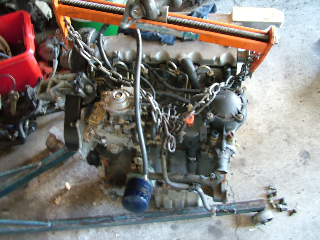

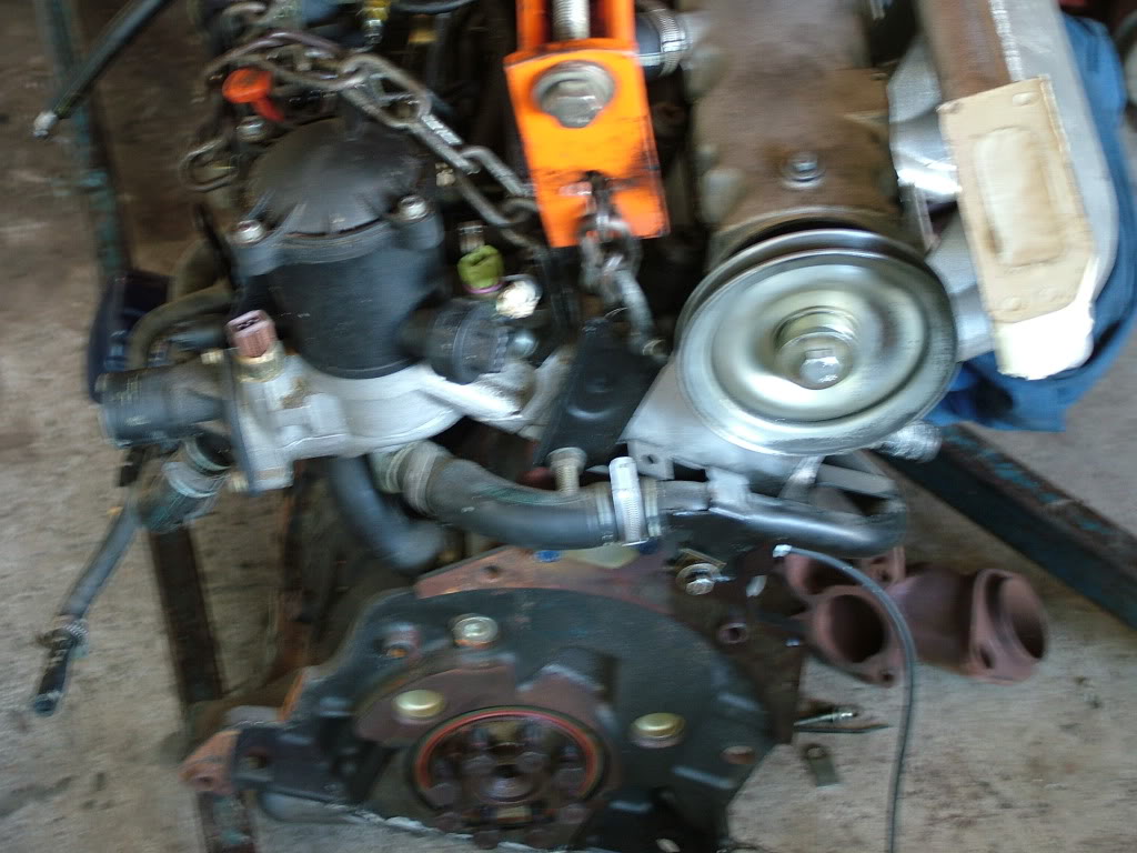

I recently found myself with a nearly brand new 12000km engine from a written off Peugeot 405. car was written off 15 years ago and the farmer who had the engine was converting the flywheel to fit it into a Lada Riva. thank god he wrote that off before he could fit it. he got hold of me and i bought it. anyway

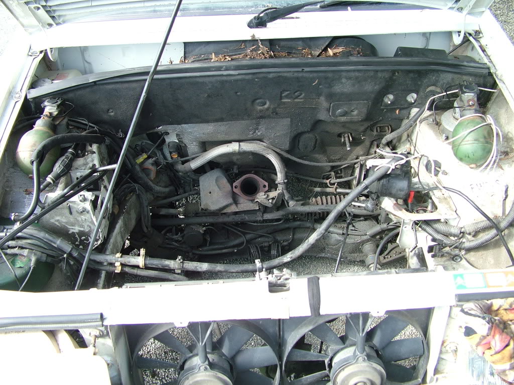

Got the BX with a head gasket gone. thought yeah i can fit the 405 engine in there.
so it began. had a look at the camshaft found it to be slightly different. no problem. i machined my Hydraulic pump pulley to fit the end. then i drilled the camshaft and cut a thread into it. then i drilled and pinned it with a large grub screw. and that was that. then i changed over a few sensors as it was a late model XUD9 and i have one of the last BX Hatchbacks. so no drama at all.
then the engine was supplied without a waste gate control for the turbo. so i set to work making one up for the min. untill i get a proper one from my mate in the uk.
all i am waiting for now is the clutch and other parts to arrive from me mate in the uk and it will be going back together very soon.
i am now off to strip the gearbox and do some well needed checks.
I have always stripped the gearbox when i have it out as i had a TZD that threw a diff bolt out of the case one day. so make sure if you are doing a clutch to check the diff bolts and the fith gear nuts. i replace mine when i do clutches.
will be good once it is done.

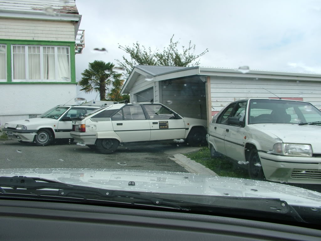

My garage at the moment looks like this:
I dont trust anybody to do anything on my car as there is nothing i cant do.

looks like you've cornered the NZ market in white BX's!

Yeah i have found myself totally by accident with all white BX's. there will be another white one turn up when i get back from australia. in june.

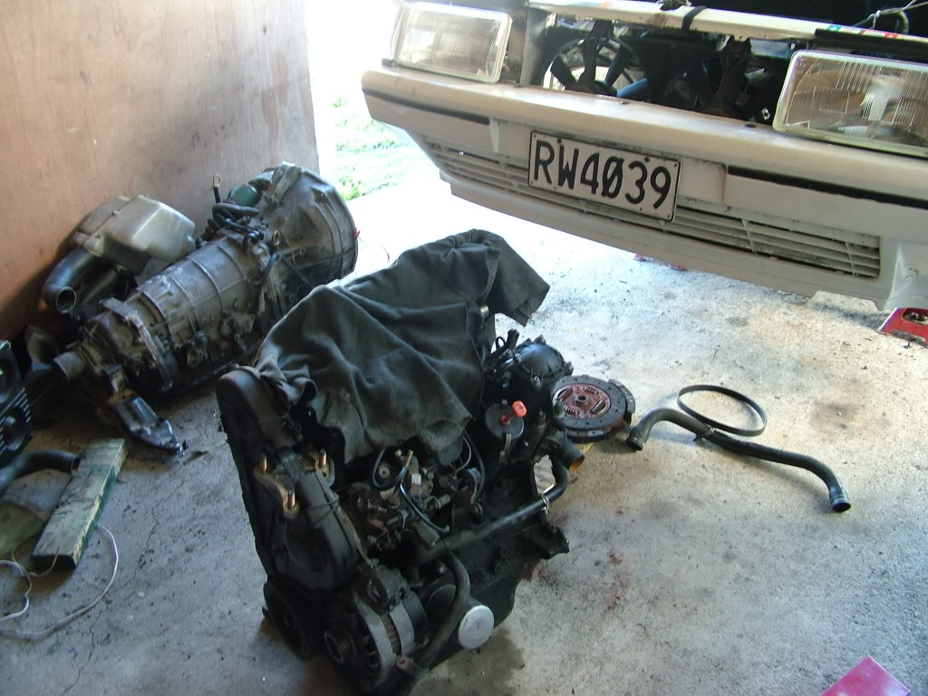

what on earth is that gearbox out of??
djm666
Posts: 233
Location: Nelson, New Zealand
bx rebuild
Post by djm666 »
Yeah the gearbox in the background is one out of a Subaru Legacy. had to rebuild another one for my brothers car. he is fully into Subaru's loves them.

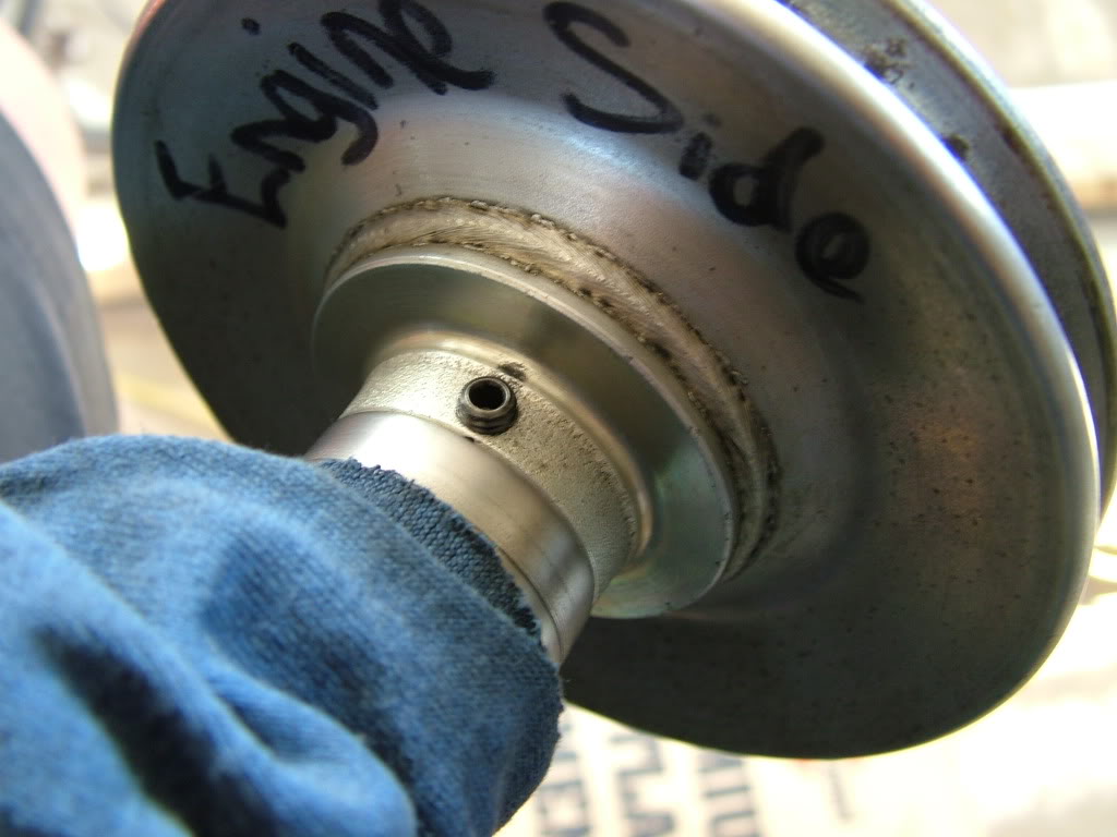

I bought a complete new XU9 head off Ebay which was supposedly for a BX but, like you're saying, the cam doesn't have the flange for the pump pulley so it's probably Peugeot. I only found out when I came to replace a broken cam. I'll have to follow your example and machine it to fit.
I see you like white BXs particularly and what's that sticker on the door?
Maybe you want to have a pause on the BXs to fix that bit of your house that looks as though it's gone rotten on the corner? :D ( That'll let the weather in)
Make sure the head has the oil feed to the head mounted vacuum pump blacked off, otherwise you will lose 'rather a lot' of oil...
IIRC they all have a tapped hole on the HP end of the head, but is blanked off on BXs and Xantias. I've seen it blanked with either a hex headed brass grub screw or a ball bearing hammered into place!

yeah i made up the plug for the head. as the peugeot one was just a hole for the oil drain back.
i can draw up what i did to the cam and the pulley to make it fit. really was simple did it all myself with the tools i have here at home. me and my dad holding a camshaft still while i drill it in the garage was funny. did not want to put it in the vice as i dont have any soft clamps yet.
i just really wanted to keep the engine with its original cam as it has only done 12000. i made up the wastegate control the other day as it was missing. i made up a controller for it out of an old CX idle adjustment screw. and i have bought a gauge for it so i can make sure not to over boost.
The stickers on the car are my business. i have started up fixing and repairing european cars in nelson new zealand. it is slowly taking off. me, my brothers and dad are all working together. a real family affair.
