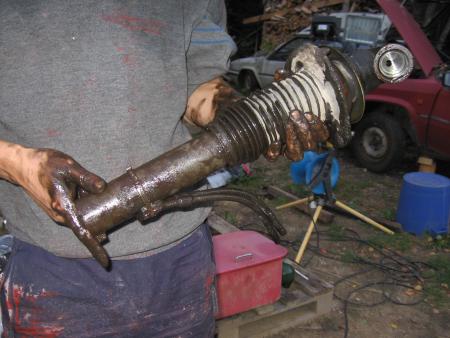

I've gone through a number of those:
http://www.rmattila.com/images/remontit ... ppa_avaus/
At least here, a typical root cause for front strut wear is a broken breather hose, which lets the winter salt mud stuff inside the thing. It can't escape due to an incomprehensible design flaw in positioning the breather holes, and eventually leads to corrosion of the piston, which in its turn wears out the nylon seal.

There:sdelasal wrote:Riku - where is the breather hose on the strut then?
The bottom of the strut is a cup, from where water/mud has no change of escaping once it gets there.

I think what you describe Riku happened to one of my struts - the return/breather just wasn't there and I don't know for how long it had been driven like that.

I have done several of these successfully.
Actually the only parts that wear are those inner seals and then also the wear ridges on the inner piston have to be polished out to cure that jerky front strut action.
The top thrust bearing also must wear a bit but the main issue I have discovered is that it just dries out and needs soaking in new lubricant for a while to restore a smooth action.
The white plastic castellated spacer/locater around the large outer piston also wears after a high mileage and eventually results in a front suspension knock on bumps but this seems only to occur after a high mileage of at least 250k.
I use old hubs clamped to top and bottom of the strut to hammer the thrust bearing round and out of the strut cylinder.
