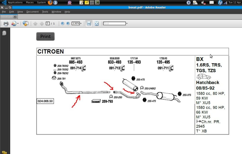

Okay - here's where they said it was leaking
I got the impression they meant taking apart and re-hanging and re-clamping (i.e re-jigging the joints) rather than using sealant.
As for the age of the system - the downpipe is by far the oldest part
Rear silencer 04/2005
Inter silencer 03/2006
Link pipe "hockey stick" 03/2006
Downpipe welded... 03/2006
It didn't help that the inter. silencer was originally installed with the pipes connected the wrong way :roll:
Also I go over big old rubber speedbumps every day at work so the system gets a lot of shocks.... and I catch the crossbox / clamp bolt on mum's drive when I go visit.
Cheers,
Mark.
mnde wrote:I got the impression they meant taking apart and re-hanging and re-clamping (i.e re-jigging the joints) rather than using sealant.
I can't see anything that would cause the joints to leak, that could be cured just by taking apart and putting back together though...
mnde wrote:I catch the crossbox / clamp bolt on mum's drive when I go visit.
...unless physically dislodged!
It sounds like you are getting a good life out of the system, I only got 3.5 years (60k miles) from my genuine Citroen rear silencer before the rust ate it.
