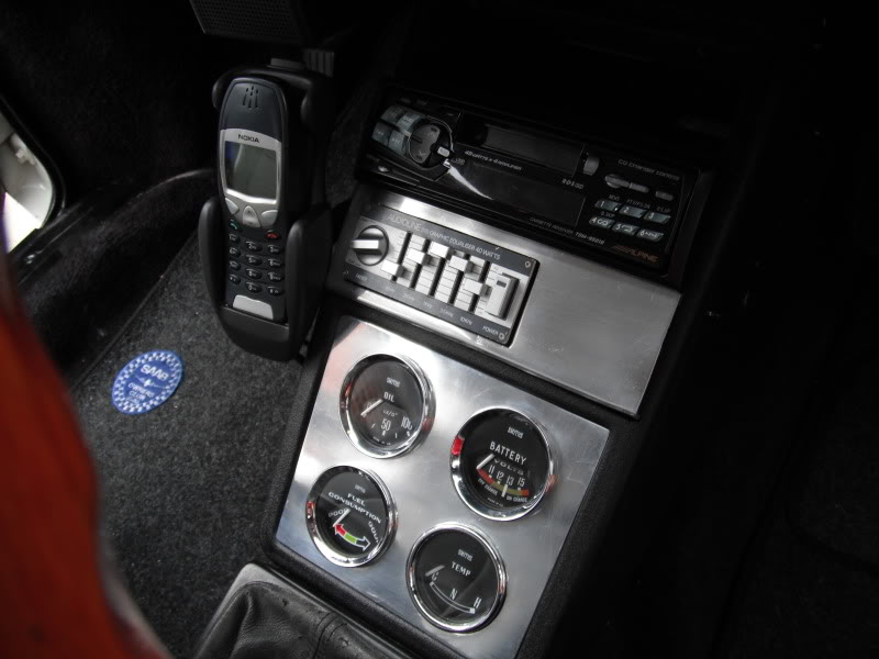

fitted these to the saab 99 today,its what i should have done to the temp gauge on the bx. custom make an alloy panel and cover thee coin slot and ash try.

It doesn't get much more 80s retro than that Halfords/Audioline graphic equaliser! I think I may well still have one of those lurking in the shed somewhere.
The aluminium panels are very nicely done - chapeau, as they say over here.

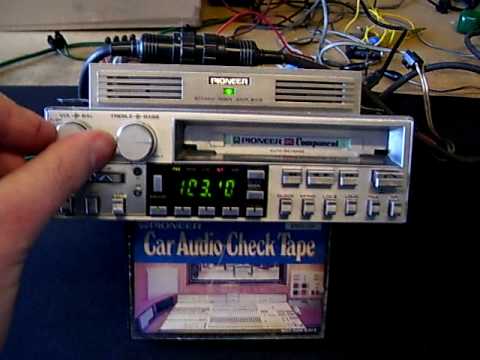

I agree it looks great, but please change the head unit for something matching. I'd recommend a Pioneer - they made some lovely looking silver car stereo stuff:

Why not buy a Pioneer with a knackered cassette deck and wire in an iPod (many Pioneers support a line in, or use an FM transmitter)? That way you can carry hundreds of CDs with no risk of them getting scratched or stolen. Original looks and sound with modern convenience - the best of both worlds

That 'fuel consumption' gauge is actually just a vacuum meter that measures the inlet manifold depression. In fact they can be quite useful little things for telling you stuff about your engine - like if you have a leaky valve seat .......... the thing flickers.
They are also very good for setting up tappet clearances if you have a motor than be adjusted while the engine's running.

the above answer is correct. the gauges just give you more information about whats going on under the bonnet. with a turbo its quite important to know when any perameter changes.
i was on e bay last night and looking at silver pioneer seperates as you were quite right sir they do look better. scared myself to death,have you seen the prices? may have to start doing the lottery. this stuff is just old not classic. valve car stereos are classic not pioneer surely?
