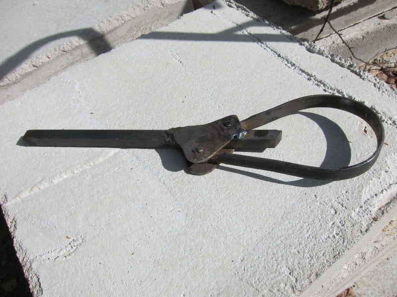

Didn't feel sleepy last night, so I went to the shop and came out with that thing a couple of hours later:
Seems to work OK, but I think I'll alter the dimensions a bit for the next model to make the gripping force a bit larger now that I have found the appropriate dimensions. (It bites and holds well after getting the initial grip, but needs a bit of force in the beginning to get things started.
Does anybody happen to have the dimensions for the original tool? It would be interesting to make some comparison.
