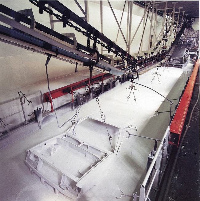

Not enough cars get the "submerge in milk test" nowadays...
You see to me thats just porn...
toddao wrote:
This is porn, what has that robot got stuck up the a-se of that estate??
:D I think they were testing it to see what sort of load it could take!
It's a Heuliez device for removing rust protection from the n/s wing. They had a similar device for the Xantia and XM.
I've got a book about H vans with a picture of them being dipped on the production lines. The book's French, while i have enough trouble with English, but with my experience of 70's Citroens I'd come to the conclusion that it was a salt solution they were dipping them in!
