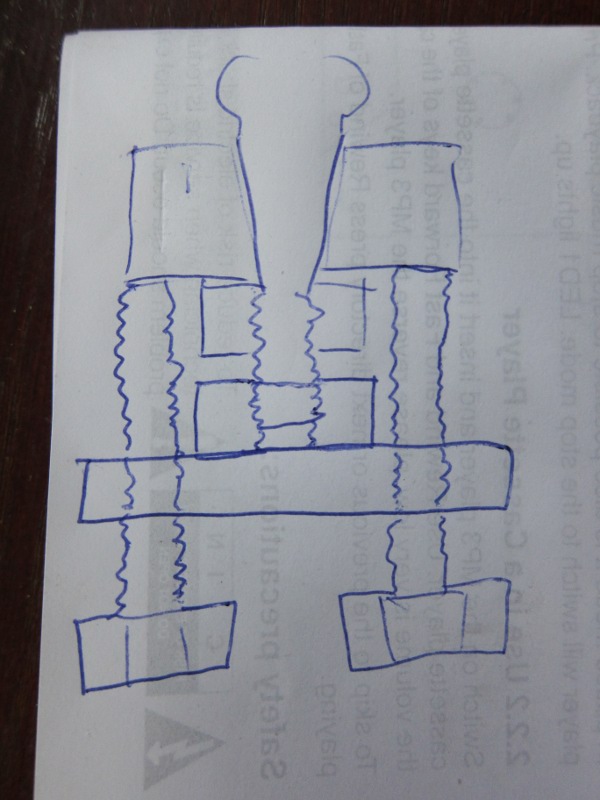

I once had a similar situation and solved it by making a "taper tightening tool" such as in the sketch below:
The tool consists of a nut welded to a bar with two threaded holes. The idea is to turn the central nut to the end of the joint thread, and then pull the joint taper tight with the two screws going through the threads. The nyloc can then be tighteded while the tool keeps the joint from spinning.
