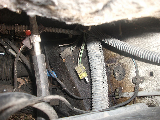

I had speedo issues last year, the lower cable snapped on the way to the National. We suspected this but weren't sure. Vanny gave me a spare speedo and I bought a new upper cable for pennies at the show both are in my loft and yours for postage cost if you need them. I'm not on here masses so pm and wait
The lower cable can be replaced with a 2cv part which I bought from Martin Lockwood. This is the easiest bit to replace and apparently the most likely to fail so worth trying first.
To replace it
DSCF9490 by faery-jaya, on Flickr
Find the cable as it comes out of the bulkhead, using fingers undo the top cable from the lower
run your hand down the cable to where it enters the gearbox
pull rubber pin out to release cable
replace cable with slightly longer 2cv item
worry when you realise how fast you've been driving since it broke
