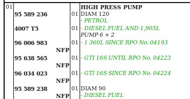

That's what the catalogue says:

Hmm so the 1.6 and 1.9 petrol have different pumps then?

Roverman wrote:Hmm so the 1.6 and 1.9 petrol have different pumps then?
As I read it, the "DIESEL FUEL AND 1,905 L" means 1,9 litre diesel engines, not 1,9 litre petrol engines and diesels. So my interpretation would be that with the exception of GTI 16S and the old 1,360 engines, all petrol models would seem to have the same pump # 95 589 236.
However, I've learnt not to trust the catalogues blindly, and since my experience is almost exclusively on diesel models, can't say for 100 % sure.

i belive mostly the diference is to do with were on the engine the pump is located, exccept for the odd one out being the 1360 lay back pug lump,
