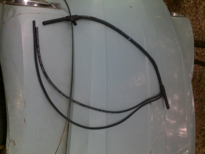

i have not worked out how to copy images from service citroen yet,
but both pipes look the same appart from the first one ending 421 has a junction bonded into the lower section just before the end,
looks to me if it is long enough you could lop off the end just up from the bonded junction, or just plug the junction/branch off

I've seen a photo on another forum of the first one 95603421
Looks like the two long thin arms are the height corrector returns (connected to somewhere near the bulkhead - where?) and at the other end the short stub fits on the PR and the other goes to the steering return?

Nope - I've consulted a diagram and the long tentacles go to the front and rear height corrector returns respectively. So I can see where one attaches to the front HC from a piccie I found, then I assume the other one attaches to a long rigid pipe that travels under the car to the rear HC...
At the other end, the short stub on the T piece attaches to the pressure regulator and the remaining pipe goes to the pinion valve return.
Now Doc tells me this pipe is NLA from Citroen (diesels have a different pipe that isn't interchangeable) and is trying to source me one - thankyou!!

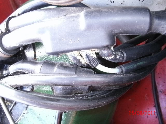

I have a similar problem on the TZD, this has 3 small diameter pipes connecting to the main pipe just right of the LHM tank, and have been assembled so that the pipes bend through 90 deg, which has put undue strain on the rubber.
I have managed to sffect a temporary repair using 4mm od ptfe pipe from a mig welder. "Pic below"
I am looking into a more effective DIY repair using push fit connectors and nylon pipe, will post some picies of the work in progress.
But I am waiting to see if the seals on the connectors will withstand prolonged use of LHM fluid.
