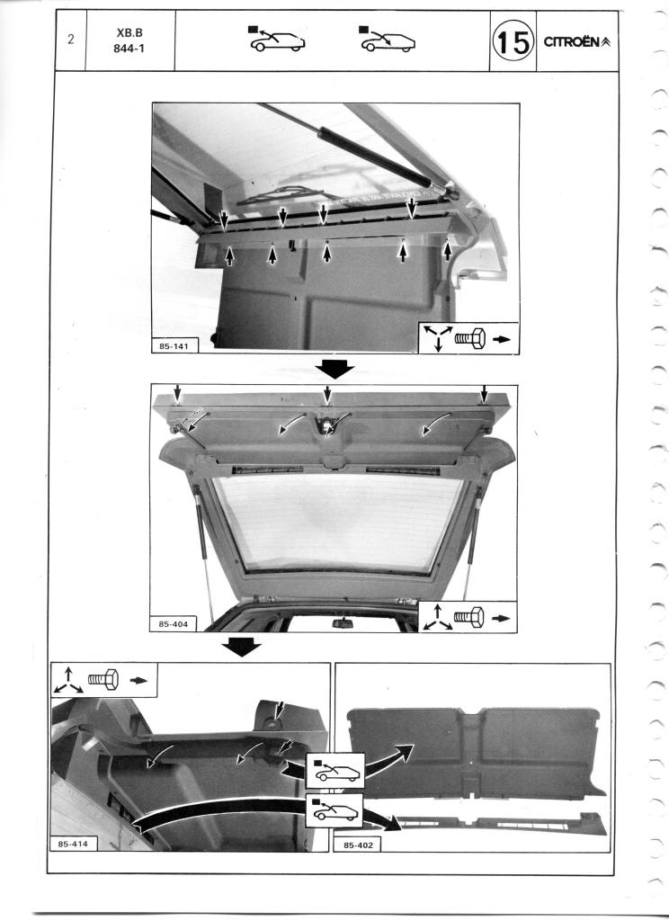

Thanks for that. Next question. How do you go about removing a tailgate? The one currently fitted has a broken hinge. This makes holding it open rather difficult, which is causing me concern when it comes to the wiring...
Would it be easy enough to cut the wiring and splice in the wiring from a new tailgate? Or is there a miraculous plug somewhere that I can simply undo?

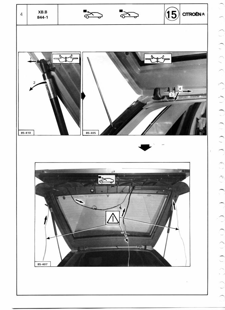

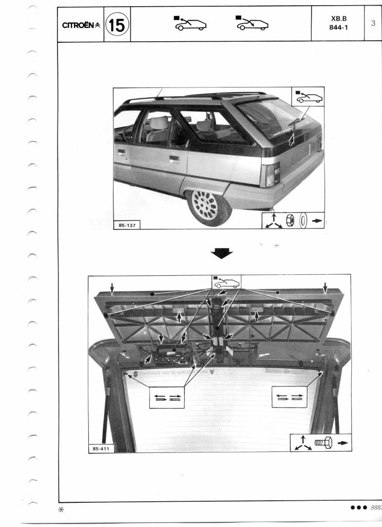

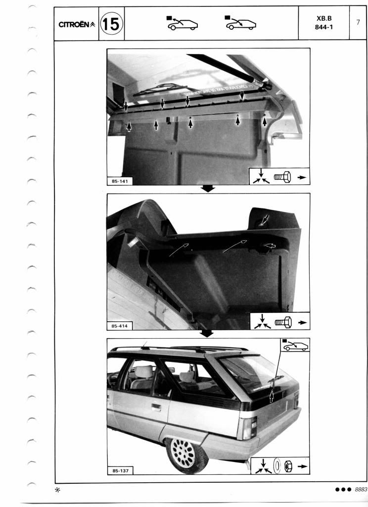

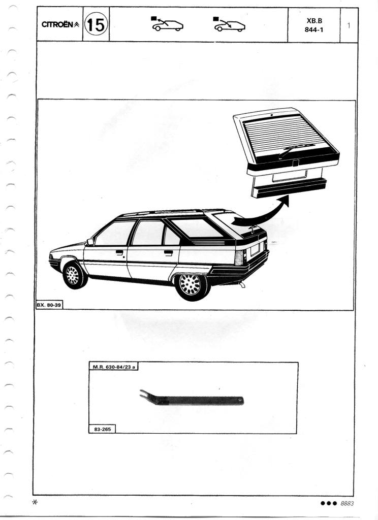

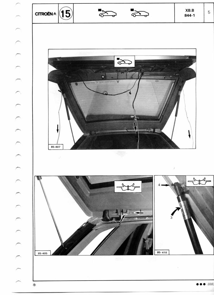

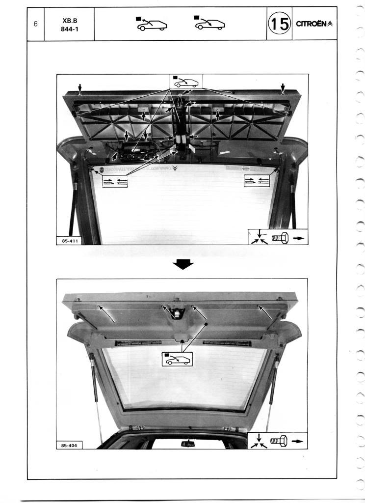

I found how to take off the tailgate in the Citroen Dealer Manual.
I will scan these tonight and see if I can remember how to attach the scans to a post.

Image[/img]

Lol They make it look so easy to dismantle a tailgate? Has anyone ever managed to remover the bumper section from the bottom? Unscrew the screw and much force later.... nothing will budge!
Actually removing the tailgate is simple though. Disconnect and pull the wiring through, disconnect the gas struts at on end and the washer pipe, and remove the hinge pins. Et voila :D

Thanks Neil - sorry, missed this when you originally posted it.
The tricky bit is going to be sorting the twisted hinge out. My body repair bloke is happy for me to work on his premises, so I'll get the tailgate off and then he can work his magic with the hinge. Hopefully...
